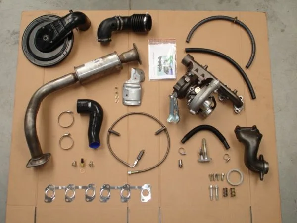

  1. Turbo - I did it. After a couple years of saving I finally threw down for a turbo kit for the 1HZ. I went with a kit from All-American Imports out of the Netherlands. What I liked about this kit is that it uses a lot of Toyota parts including a CT26 turbo, HDT exhaust manifold, and boost compensator for the fuel pump all for a pretty fair price. It came to a little over US$2400 at today's exchange rates including shipping to the US. No intercooler, at least for now, and I plan to keep boost at a modest level to maximize fuel economy and reliability. We'll see how long that lasts.

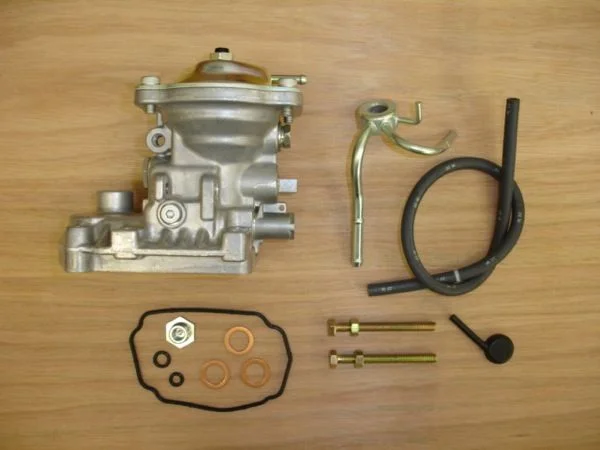

PICS:
  1. AAI Turbo kit
  2. Boost Compensator
