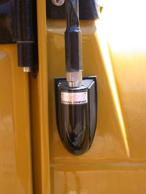

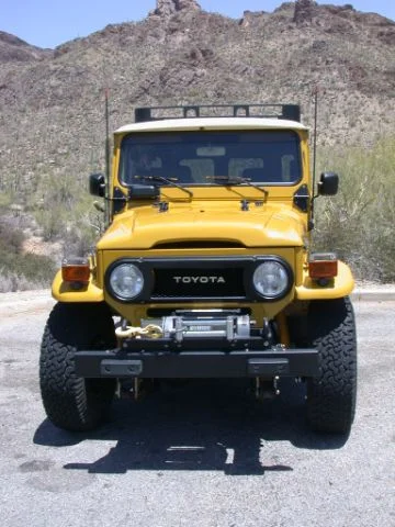

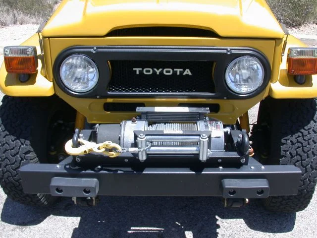

I use Firestick but I'm not entirely happy with them and plan on switching to Wilson. Here is a pic of my dual antenna setup.

got any close-ups of your mounting?
Those look good.

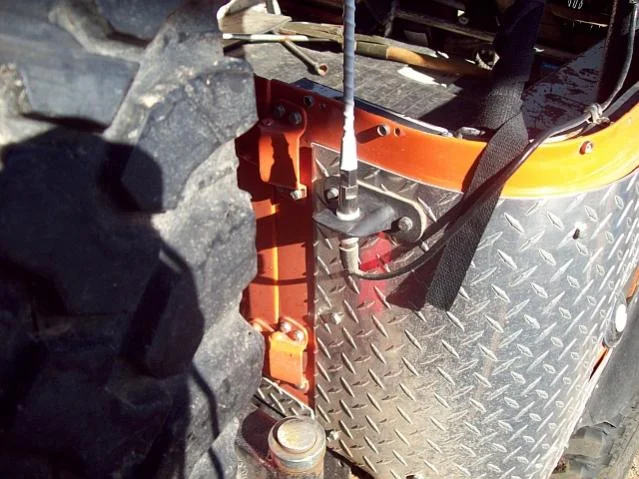

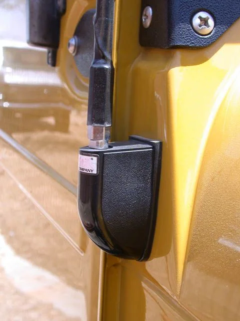

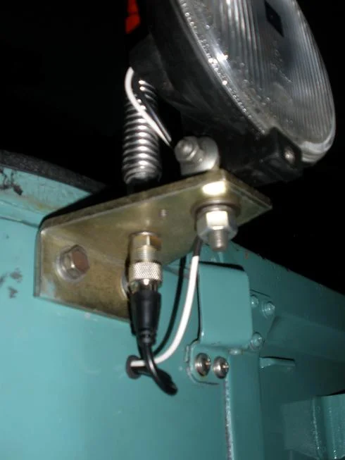

Here are some antenna mount pictures

wilson all the way,,, and i personally run a trucker 5000.
bsevens is your system set up to run duals? i think its a waste myself, unless you spend most of your time on the hiway and like to project for/aft.

Thanks for the pics, how big a hole do you have to cut to get that thing in there?
I like how clean it looks installed.

I like the finish on your hinges, and the new hardware. It looks very crisp.
I'm hoping to get a 3 foot flexible, tunable Wilson to go on the ARB bull bar. I will probably add a spring mount too so that the height is slightly above my roof rack. I would like to go higher, but I have to fit in a parking garage at work during the week.

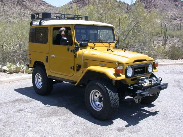

All the hardware I removed is replaced with Stainless Steel H/W. The paint you refer to is the result of sandblasting and powder coating with Cardinal Black Hammer. This particular powder coat finish is the toughest I've come across, very durable and can take a serious hit. It will not chip. I've taken a 4lbs sledge and a 2x4 against the mounting frame for the winch and beat on it till it was aligned for the mounting bolts. Not one scratch in the finish. All it did was dull the surface finish. In the attached photo, if you look closely at the winch right side mounting frame at the back you can see where the 2x4 split and slide over the top when I hit it with the sledge. Every thing black on this vehicle has been blasted and powder coated alike. The exceptions are on the list to be removed and done (sliders). When I get a moment, I will replace this photo with a closeup giving you far better detail.

You've got a great looking 40 there. I hope mine looks as good someday. It's on my list, to restore that is.

I've broken alot of firestiks, so I started picking up fiberglass whips at the local Kenworth dealer. At 8 bucks a pop, I can afford to have a spare or two laying around (I think they are more flexible also).
My home fabbed mount out of scrap.

I did the same thing. I found these brackets for something else in a lab I was decomissioning a few years back. After cleaning out the garage a few months ago, I decided to go with this thing since it was already zinc plated.

I like the dog.
