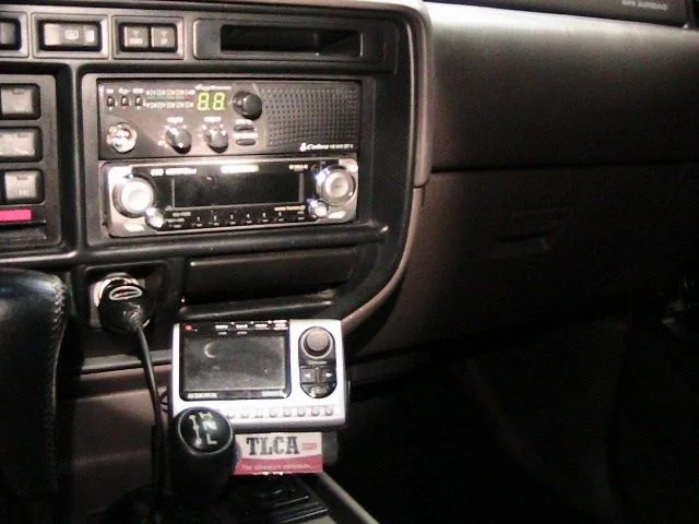

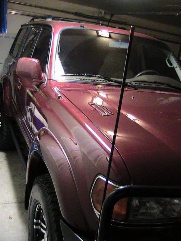

Follow up report
Well, thanks again to everyone who gave me good advise. Thats what I love about Mud ~ quick and educated advise on the what, why's, and wheres....
Per the thread I did go with the Cobra Cb single din in dash and the Firestick. I had to mount the stereo under the cb due to the backside length of the cb. No matter to me though...the front speaker feature was great.
The trail run performance was a success - I am very happy with the Cobras performance, features, and range.
Again, thanks for the advise! Heres some pics of the final results:

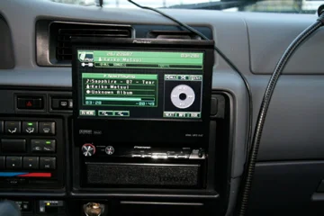

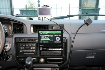

Question: I'm considering to do the same installation, but I can't put the CB on top of the stereo, because the stereo is a flip screen and would block the CB. Any alternatives? Thanks in advance.

My CB is below the stereo. Would your flip screen work in the top position?

Yes, the flip screen works fine. I'm a little concerned about the depth (backside length) of the lower DIN, as Murf was experiencing. I can off course disassemble the console, but I would rather not do so if it will not fit anyway. So what type is your radio?

Hi all, just found a thread with pics of the lower DIN installation for a Cobra, so it seems possible:
http://forum.ih8mud.com/80-series-te...l-cb-like.html
I will take my chances...
My radio is the same as Murf so that's why I suggested going with the lower slot. If memory serves, I *may* have a 90 deg elbow for the coax but not exactly sure though.

A 90 degree elbow makes it work in the lower slot. Or you can hack into the coax and put a flexible mount on.

You can mount the Cobra in the bottom, but you have to modify the coax jack to do it. There is a write-up in the 80 forums, but I don't recall where. I was too lazy and mounted mine on top.

Mmh, the Cobra 18 as mentioned above is not on sale in Europe... So I will have to switch to another brand (I don't want to buy via the internet, as I don't want the hassle when it breaks down to send it back to the USA etc.) . People keep telling me I should go for the Midland 48 Excel, as it is being used by most overlanders and off-roaders here and being very reliable.
Accoring to the specs, the Midland is 1 centimeter (0,4 inch) longer than the Cobra. Now we all know that size does not matter, but in this case...
Why didn't someone think of producing a shorter CB radio!
Here is a picture of the Pioneer with the screen open. If I would put the Pioneer in the lower din, the screen would be in front of the to-be CB.

Quote:
Jurgen
It is only the coax that makes it too long... Just open it up and solder on a pigtail for the coax jack. It's easy to do and should solve your clearance problems.
