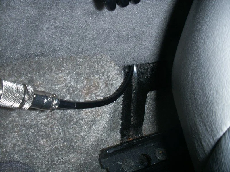

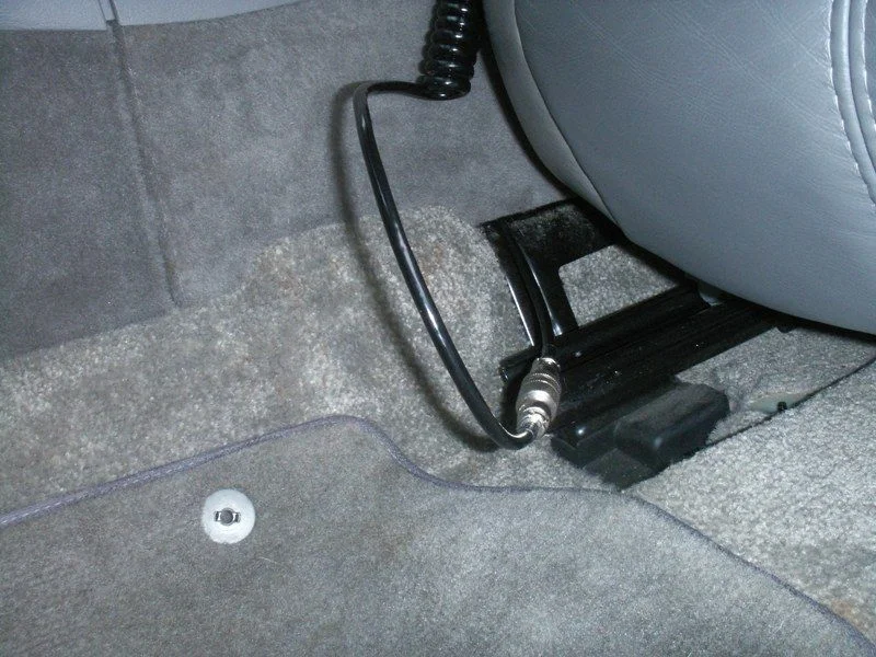

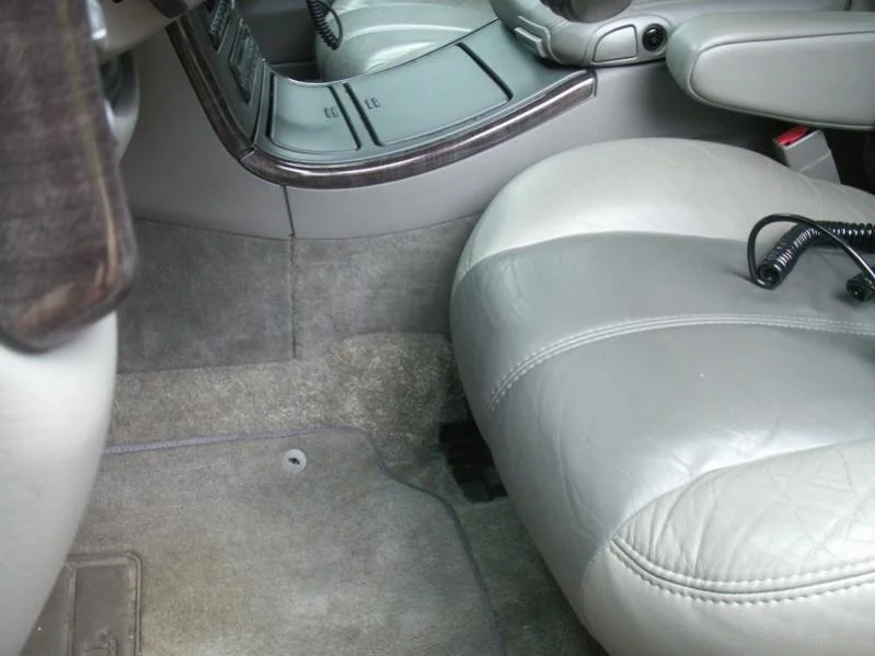

I then mounted the control box under the console in the void, ran power to it, and fished the short connector cable out next to the DS seat rail. This proved to be convenient for many reasons:
1) When not in use, the 'pigtail' tucks rearward between the DS seat rail and the center console where it is completely out of view and does not interfere with the movement of the power seat. When needed, it is easily accessable and leaves the full length of the handset cord available for use.
2) By mounting the control box in the void beneath the center console, I have easy access to power from either of the three 12v power points on the center console (switched or always-hot) or I can easily route power directly from the battery.
3) The mounting location beneath the center console cupholders allows easy access to the inline fuse and the unit (for SWR meter hookup and testing) via the removable access panel inside the center console storage compartment.
4) The 18' coax of the Firestick 'firering' coax would not have reached from the rear of the Yukon XL to under the front dash even if I wanted it there. I ended up with about 8" of 'play' inside the center console.
Here are a few pics of the final install (and yes I know the carpet is really dirty - this is a long-trip kid hauler (but I did clean it all out after the install, and the cleaning took longer than the antenna install).

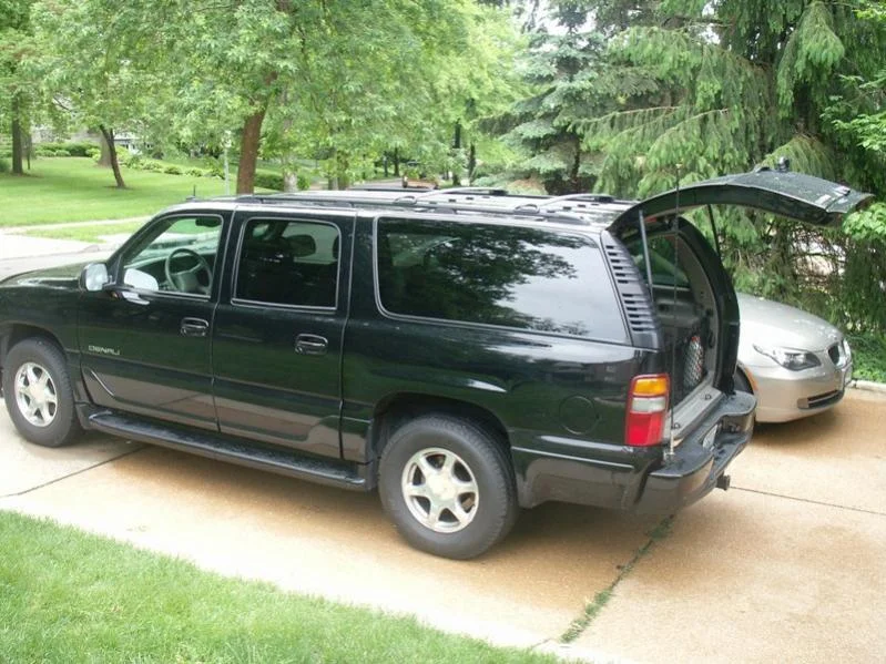

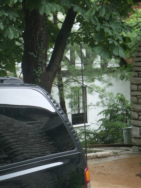

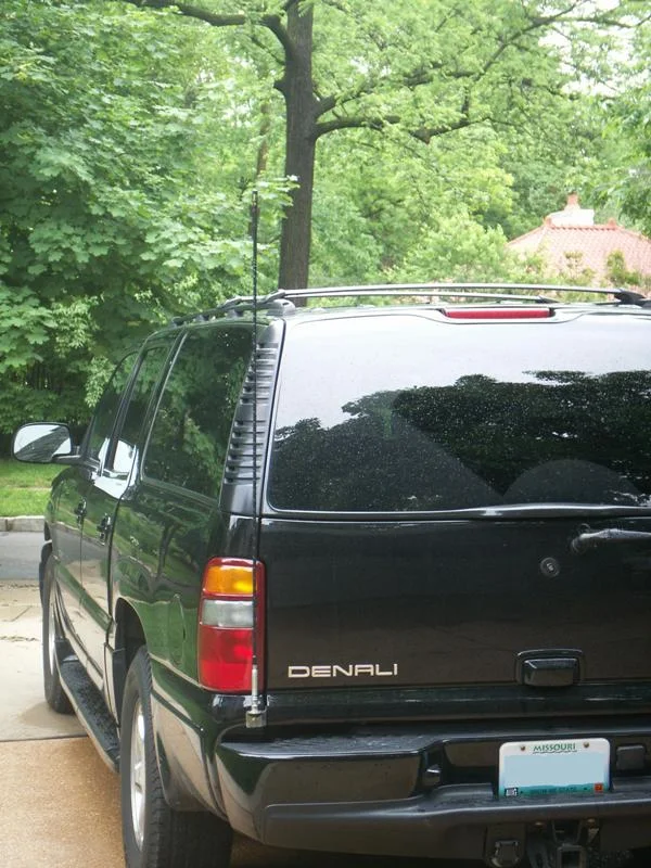

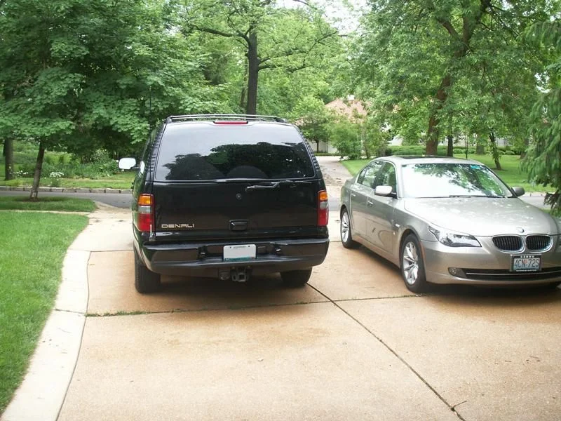

I knew the placement of the mount on the lower DS corner would give me some limitations on tuning, but my thinking was that I use a quick-release mount and only have the antenna in place on long trips so garage clearance should not be an issue. NONETHELESS, I wanted to make it possible to go under fast-food drive-through windows and hotel garages if possible without removing the antenna (though I'm sure it wouldn't get hurt anyway). Mostly, I went with the lower location b/c it made the antenna stand out less. Below are some pics of the final antenna install (sorry, I didn't realize the antenna blended in so well with the background until I started this thread and its too dark now to get new photos).
I know only about 1/4 of the antenna length is above the vehicle and I will get reduced reception due to signal blockage from the vehicle (even worse if I add our car-top luggage carrier for really long trips). But I'm hoping to get decent range forward and rear by placing it on the DS.

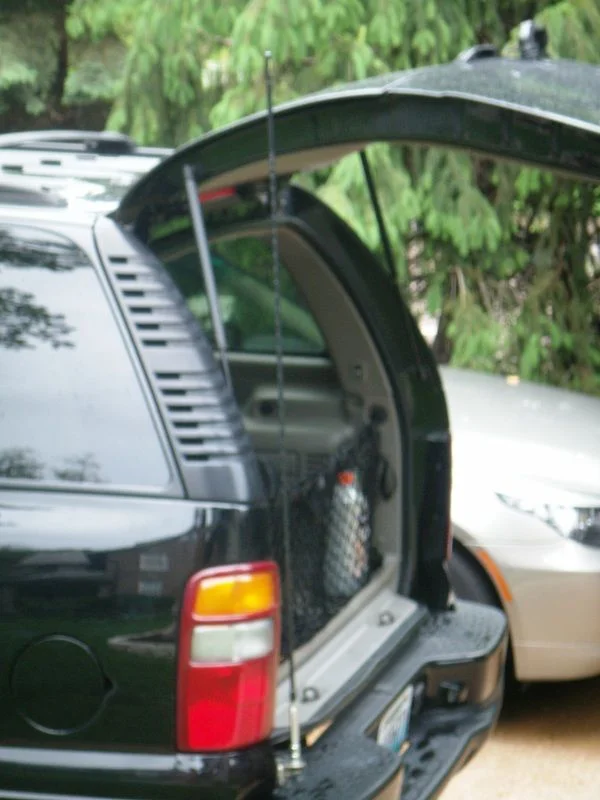

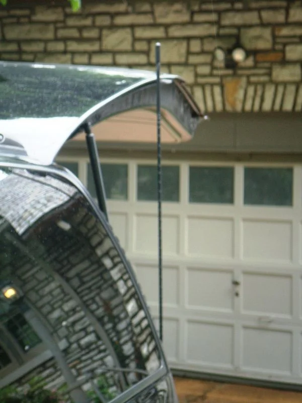

When I initially checked the SWR, I had 8-9 on all channels (whoa - really bad!). I had already checked for ground shorts and continuity from the center pin to the outer ring and mount, so I knew I didn't have shorts. I also checked for a good ground between the mount and the vehicle chasis and I knew I was good there. In the end, I forgot to tighten down the stud to the mount and it apparently makes a big difference. As a side note, I also did all my tuning/measuring with the rear hatch open. As you can see from the pics below, this greatly affects the ground-plane of the antenna and as a result I had to re-tune the antenna when I finally closed the rear hatch and checked the SWR only to find it had changed drastically.
In the end, I was able to get 2.1 on both ch1 and ch40 with 1.3 on ch20. I know this isn't great, but I was willing to sacrifice for the beneift of mount location preference.
HOWEVER, if I were to do it again (and I might take it all apart and redo it anyway), I would put the mount above the rear light assembly. The firering coax is very clean and would not stand out or block the lights (as I feared), and the additional height would do a LOT for SWR tuning and also highway range. Moreover, as I won't have the antenna on most of the time, the additional height really isn't as big an issue as I first thought. Not to mention that if I use our Sears Xcargo car top carrier (the thing is massive) I will really need the extra height to get the radio tuned.
In the end, our short 3 hour trip (one way) this weekend yielded relatively poor range from my setup. Range was poor, reception quality was poor, and I was overall unhappy with my wasted time on the antenna install. I'll play with the tuning some more before I give up and start over, but my advice to others would be to go with the highest mounting location you can and make sure you check SWR and tune the antenna with all the vehicle doors closed.
