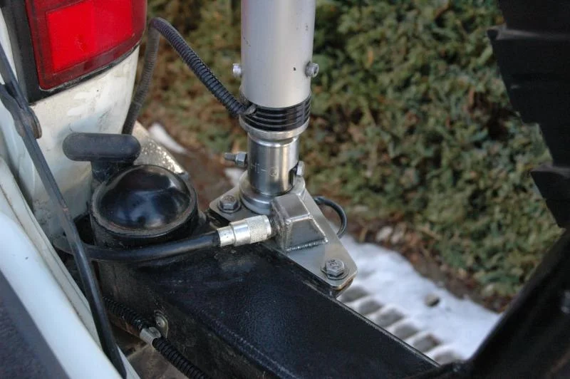

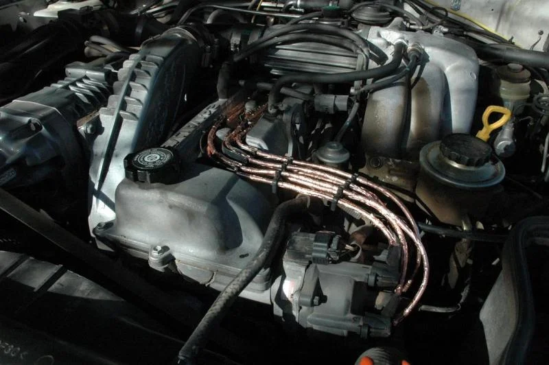

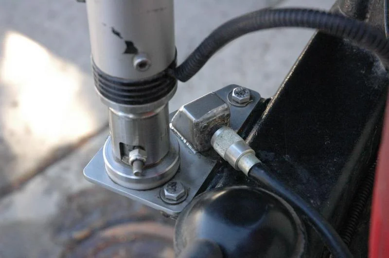

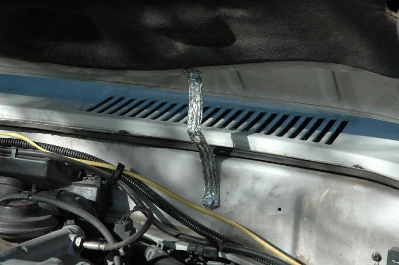

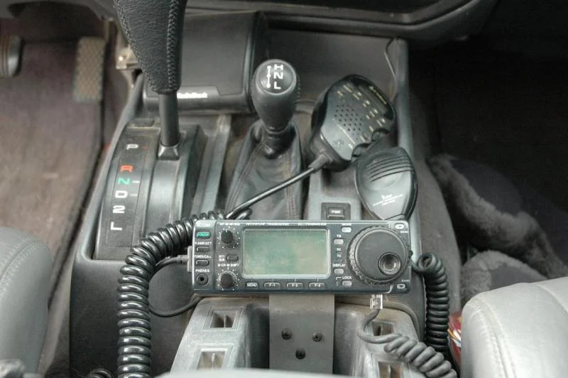

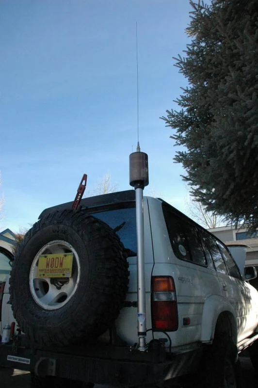

I have done something similar to 2 80's with HF rigs. One (For my father, WØDW) has the Icom 706MKIIG, a Turbo Tuner and a Hi-Q 5-80 antenna, and the other has a FT-857D, a Turbo Tuner and a Hi-Q 5-80 Antenna. Hi-Q 5-80 is a 5" loading coil and does 6 through 80 meters depending on which whip is used, cap-hats, etc. Both antennas have custom mounts, the body's are bonded and I even went so far as to shield the plug wires with 3M copper tape. I did that because I had an S7 noise level when the car was running. My next attempt at the noise suppression is to put .01 and.1 uF caps paralleled to further suppress RFI.
If you (or anyone else here) were ever in the market again for a mobile HF antenna, I personally would recommend the Hi-Q antennas due to the fact that they use a plunger inside the coil to go up and down to change the resonant frequency of the antenna instead of changing the height of the antenna similar to how the little tarheel does. 'Course the Hi-Q is approximately $200 more than the Tarheel, so I understand that.
