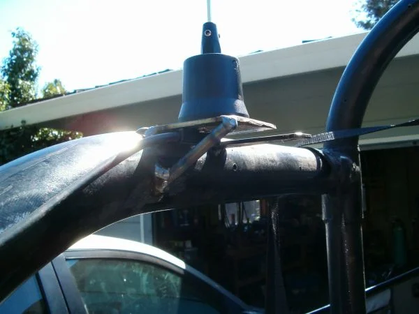

Here is my 40 installation.
73, de N6KML

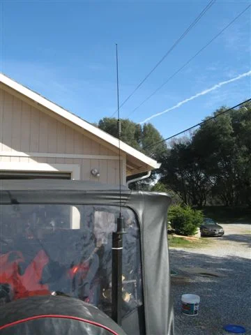

Playing with the new 1/2 wave mount on my FJ40 today-I was talking to a ham in Reno, on one of the Reno repeaters. Now Reno is roughly 100 miles from my driveway and the Sierras are between me and there.
Mind you this is with an inexpensive ($30) Larson steel whip antenna. on an NMO mount. The base plate is welded to the rollbar.
