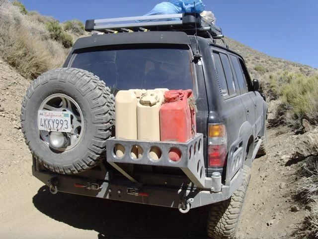

So now to the antenna. I have the Slee rear bumper that has two antenna points. One on the top part of the Tire carrier (current location of CB ant) and one on the tire carrier down near the spindle.
I also would like to be able to get it into my garage. I currently run a 2FT CB ant in town and don't put the 4ft on till I am heading to the hills (2ft fits, 4Ft doesn't in the garage).
So looking for advice and pics (if you have them) on antennas and locations with my rear bumper in mind.

0.250 Stainless plate, 18GA stainless box for a silver plated so-239. Box is TIG welded to plate all around, so-239 is silicone sealed to box. Stainless hardware to avoid corrosion. All custom.
The bumper has had mucho bonding done to make it part of the rest of the vehicle. Do not use the bumper without the bonding. For a VHF/UHF antenna I would recommend a Radial Larsen 5/8 wave mounted to the roof using the roof as the mount. best ground plane.

Thanks for the options, but a requirement is to get it into the Garage. Roof mounting won't work and a 3 ft ant with a rear hatch lip mount may work.
So Nathanila (Groucho) is I was thinking of the same spot that picture shows. Is the performance good with the proper bonding.
There also is the front bumper and possibly some of the hood mounts I have seen.

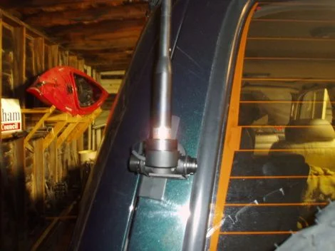

I have the 7800 and copied Cruiserdrew's hatch mount. It is ideal for trail use.
The antenna is flexible and barely goes above the roofline (is not higher than my roofrack). Does not interfere or hit the roofrack when you open the hatch either. Works awesome.

I can't find the detail shot but here is a recent pic- actually the antenna does go slightly above the roofrack but that's good- it's super flexy anyway
Cruiserdrew setup: K400c mount/ sbb-1 antenna (note this mount has a 'floating tab' that adds support when the hatch is closed)

The SBB family of antennas does not need a braided ground, even though I did that on mine. It is much more important if you go to HF radios, not so much for VHF and UHF. With the K400c mount the ground is through the screw in the mount. I also grounded mine with braid to the hatch bolts, but I have learned since, that that exercise was unnecessary.
