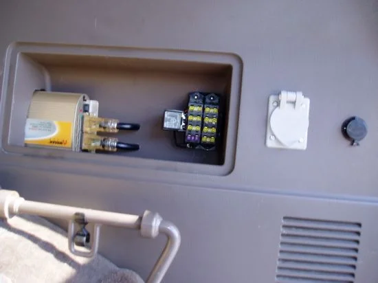

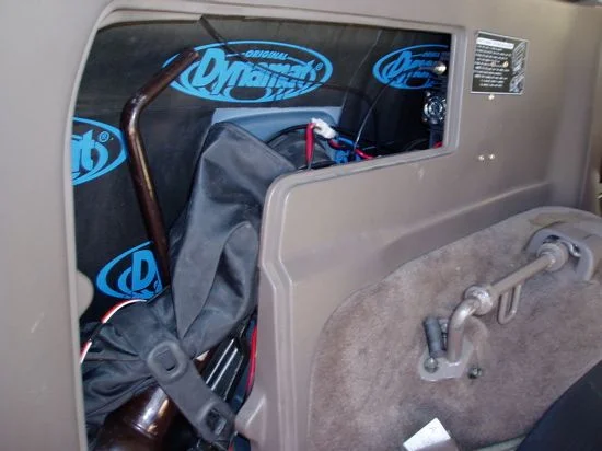

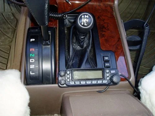

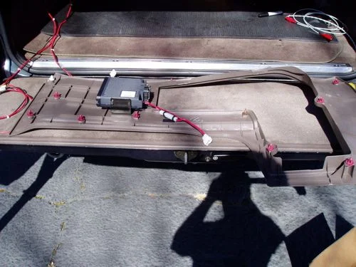

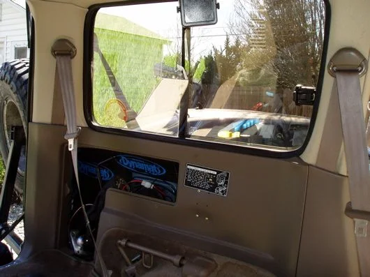

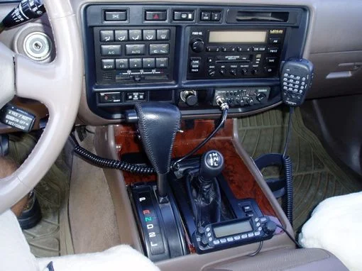

Found some time and installed the stuff.
The pics are kinda lame. the set up is working well. One thing Im not sure of is I did not ground my antenna/base ???? not sure If It would make a difference.
Pics..
Thanks again for everyones help.
ken

Some more............
And a pic of the #2 aux buss with things and the remote speaker.
ken
