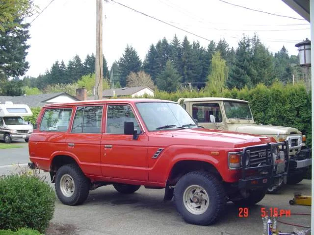

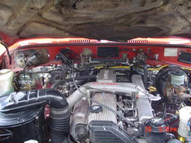

Never had time to clock 0 to 60 but in the end it was the fastest cruizer I ever drove.
The truck performed well for my customer from Vancouver Island to Bend Oregon. He never had to down shift once out of 5th on any of the climbs and was never putting his foot to the floor at all.......
All in all, I must give a hudge thanks to Sheldon from G&S Cruisers for helping me out on the intake system, in the end it looked so factory you would not question aftermarket or original.
Customer called tonight and was so pleased with the cruiser and its new drive train a paint job.

Nice job and I bet the customer was thrilled driving home.
Apart from a 0-60 time a fuel consumption figure would have been interesting too with a 60 being lighter than a 80
Someone was asking if the 1HDT injector lines were interchangeable with a 1HZ because a drunk mechanic swore they were.
From looking at that pic its very obvious that you shouldnt listen to drunk mechanics

beautiful work below the hood, but tell the customer to buy a new insulator!

5K is a baseline install with no extras, we managed to bump this one up a couple more dollars with some add ons.
A 12HT would of been much more simple to install, but nothing beats the power of the 1HD-T.
Spoke with the mechanic in Oregon who is doing some other things like long range fuel tank, he was blown away by the power and he is a owner of a dodge diesel.
Two or three 1HD-T owners are trying to band together and get a unit made to transmit the tach signal to the 60 series and gasser 80 series tachs.
I would agree with Rick, the hood liner should be replaced.
