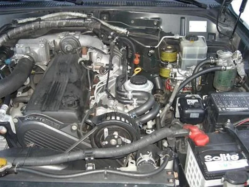

Is there a performance difference between the 1HD-T and the 1HD-FTE? Have you ever seen one in a 100 series?
__________________
1999 Toyota Landcruiser (lightly Modified...so far)
2001 Subaru Outback VDC....great car
jhkilmer is offline   Reply With Quote
Old 04-18-06, 09:47 AM   #18
IH8MUD Lifer
Tapage's Avatar
Join Date: Apr 2003
Location: Panamá
Posts: 8,675
Quote:
Yap for sure ..
This is a easy example of a 100 sereis with the most powerfull Toyota Diesel engine ever made ... 1HD-FTE .. turbo Intercooled engine .. based on the 4.2 block .. but with a lot's of electronical parts.
T
Does anyone have pics of a conversion, or international 100 series with a diesel? I like to just see the setup!!
I think this is a 1HD FTE in a 100 series??. Thats whats written on the engine but I thought it should have an intercooler

Quote:
yap the intercooler are located ahead the rad right side.
