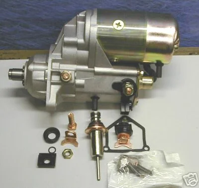

Just look up 'electric motor repair' in your local yellow pages and call and see if they have starter rebuild parts for Denso starters. (like Dodge Cummins have)
This Cummins kit will work but the contacts are slightly different on a Cruiser. Best to yank yours apart and take the parts in. It should be less than $30 for all the parts.
1.5 banana max

http://cgi.ebay.com/Toyota-Lift-Truc...QQcmdZViewItem

Question: does the above kit that Jan references on eBay most likely solve these symptoms? I ask because in the full logic of the start sequence, it seems like there could be a relay that is not stopping the starter after I let off on the "START" position in the ignition.

Hi, I don't know if the kit would fix your problem, but it is possible. If the starter relay was bad, the starter would most likely not crank at all.
sorry for the limited information. The FS, under the trouble shooting sections just suggests to 'repair starter' if it does not disengage.

Just to let folks know these parts are better (as far as I can tell) that what was in the starter originally. We'll see how they last, but the contacts at least have way more surface area than what I pulled out, and the plunger thing felt heavier... FWIW. Starter works great again.
B
