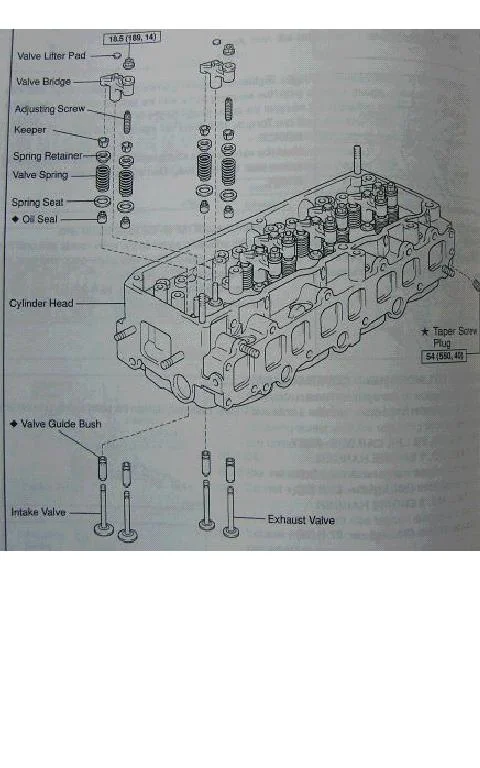

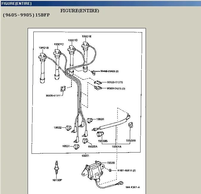

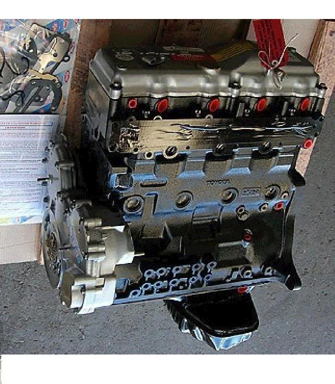

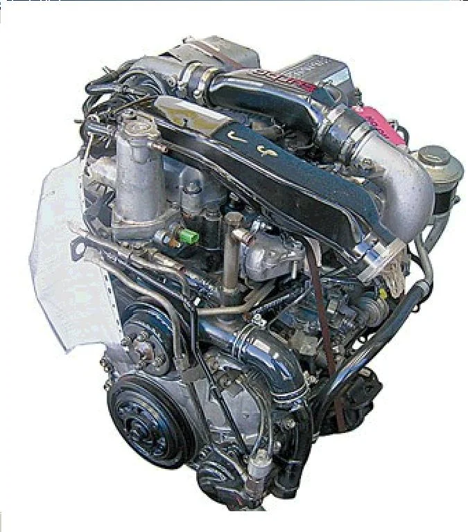

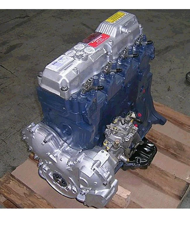

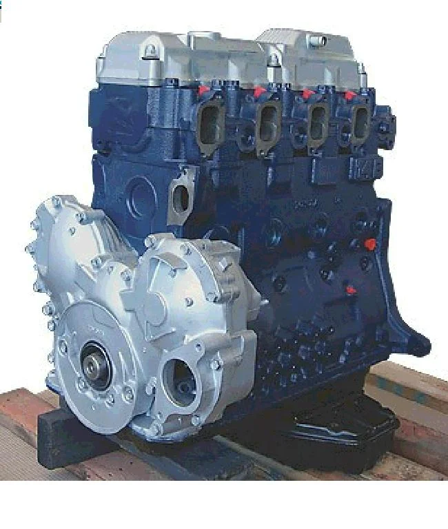

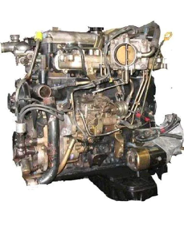

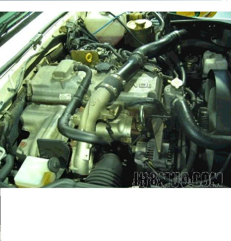

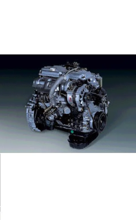

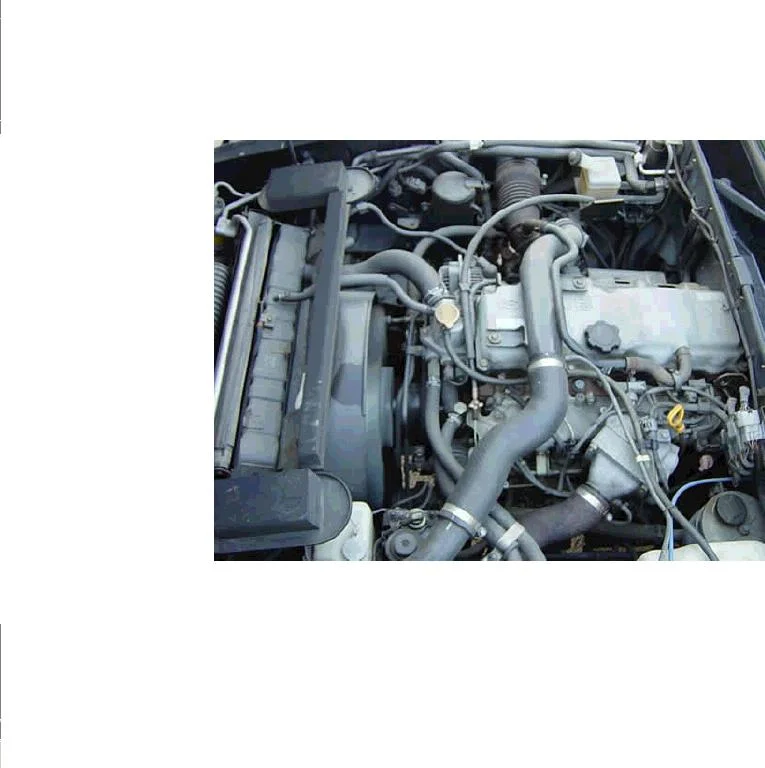

I was planning to install a 15B-FT into my BJ61 awhile back, and sourced a bit of info on these engines in the process. I posted a few pictures on the thread linked below, but will post a few more i have since sourced here in this thread.
14b-t or 13b-t
AFAIK all 15B's are pushrod 16 valve engines. There is two versions of the so called '15BT'.
The first was the 15B-FT which had a mechanical injector pump. Both rotary and inline pumps were available.
The second was the 15B-FTE which had an electronic injector pump. The FTE also its crankshaft journals increased in size over the FT. Approx 7mm for the mains and 5mm for the bigends.
The non-turbo engine was called the 15BF
There is also a LPG version called the 15BFP
The FT was used in Toyota BU212, 222 and 297 Dyna light trucks. The later FTE was used in the BU400 series. 15B's have also been used in Toyota Coaster buses, and possibly also in Daihatsu 'Delta's and Hino 'Ranger's
The Megacruiser also used the turbo versions. Earlier models were fitted with the FT engine, with it being replaced later on with the FTE.
Pic 1 15B-FT from a light truck. The black pipe on top of the engine is for the air feed from the turbo to the air filter assembly which is mounted on the left rear of the cab.
Pic 2 Hard to say for sure, but it looks like a FT. Front bowl sump, and two piece bellhousing for the larger 12" flywheel.
Pic 3 Non turbo 15BF
