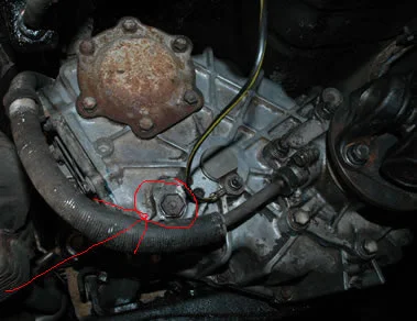

I know this is a dumb question but where are the refill plugs on the tranny and transfer case on my BJ42.. I am looking and looking and I don't see anything like a plug... please point my in the right direction.. and is it ok to use SAE 90 for both.. ?

Look for a 24mm head to the plug about half way up on the rear of the transfer case. I don't remember the size of the tranny plug (probably 24mm or 19mm). Look half way up on the left side.
This is from memory but should be close.
90 is good for both.

24mm transfer case fill.

19mm? transmission fill.

Tranny fill is 24 mm on mine at least (same year/model, same as my old FJ60 as well). Have to remove the skidplate to get to the tranny fill plug unless you're PlasticMan.

Yup 24 mm for all and use a 6 sides socket... 6 sides
