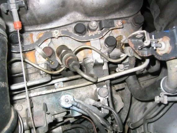

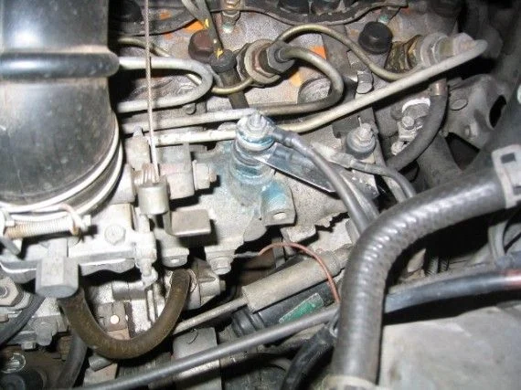

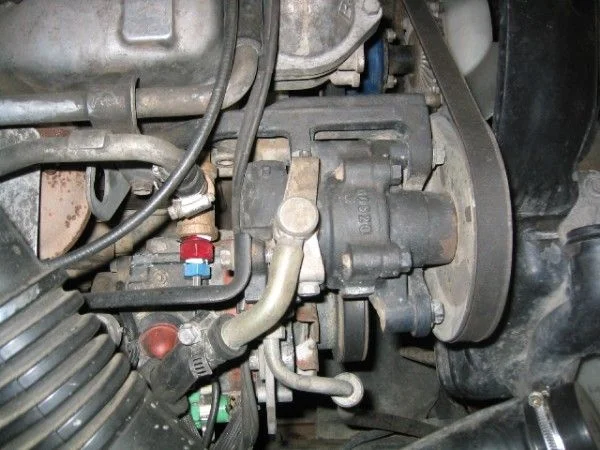

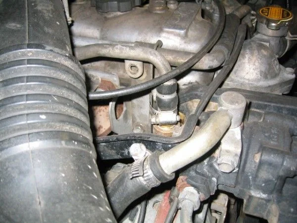

3B head installation (BJ70) - P/S bracket

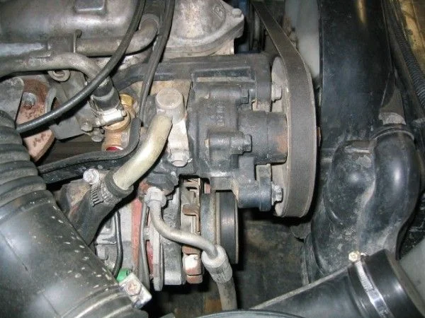

Hi Guys,
I've already installed the head and now I am about to install the p/s pump bracket, coolant fitting, if it's the right name for it and the engine hook.
A friend of mine helped removing the head and I didn't pay close attention when he removed the braket, my bad...
If anyone have some closeup pictures of the bracket attached to the head would be great and greatly appreciated
Thanks,
Alex

here you are:

another

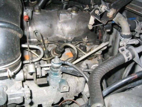

Oh.. the last one I have my temp sensor T'd in rear heater return.

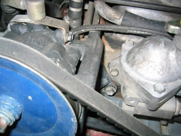

front

Wes,
Thanks man, you are great!!!

Could you please take one more picture. I am installing the current sensor and just want to make sure that 1 black wire with large round terminal goes between two insulators and the other one that has a small round terminal connects right on top under the locking nut. Hope I explained it correctly.
Thanks,
Alex
TLCA# 3558
97 LX450
bj70alex is offline   Reply With Quote

current sensor on the alt?

Glow plugs current sensor. If you look at the intake manifold, its right above the EDIC.
Thanks,
Alex
TLCA# 3558
97 LX450

yeah, that stuff I had to think about after a month or two later upon reassembly.

Yes, indeed, I took the head of on April 30 and now its already beginning of June. Yes, that exactly what I was looking for. I hope to get her running tomorrow afternoon.
