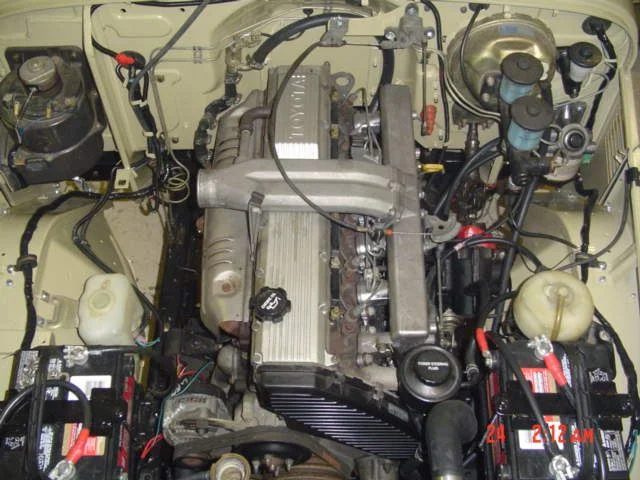

Looking again for some other options locally for a air cleaner housing for the FJ45 with 1HZ.

got a pick of the engien bay, maybe i can suggest something...
cheers

Heres a shot, if you need a better shot I can take one later.

looks like a clean install congrates...
you have tons of room for a 70,60,40 series air cleaner right in front of the intake cross over.
i would move the washer bottle to beside/in front of the blower motor. you might need to modify the air box slightly but that would be perfect spot...

I was hoping for bolt in, but I think the factory filter would look real jazzy.
Thanks for the suggestion, now who has a BJ40 or 42 housing as they are smaller than the 60s?

I second Wayne. That's where the air cleaner went on the FJ55/3B as well. I used a BJ60 housing and trimmed the mounts.

actually the filter housings are qhite simular in size and the mounting of the 60 series might match the flow of the fender better...
just picturing this in my mind...
i might have one kicking around, i will check tomorrow...
