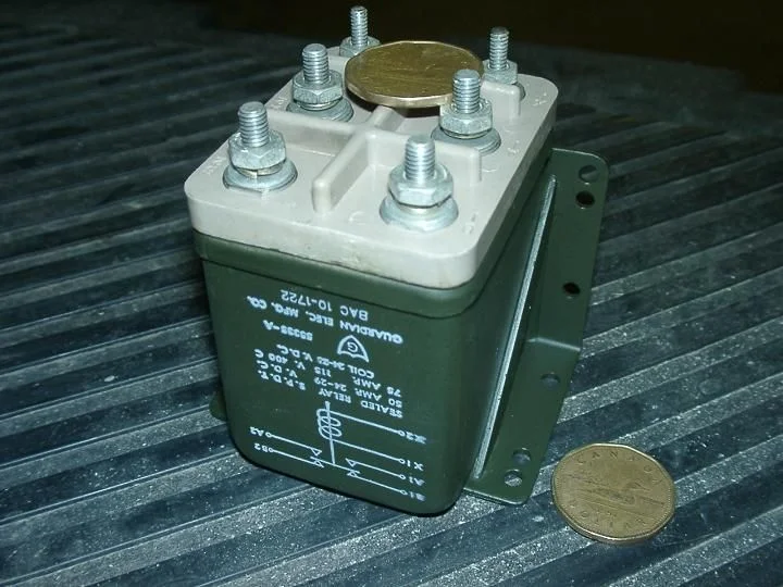

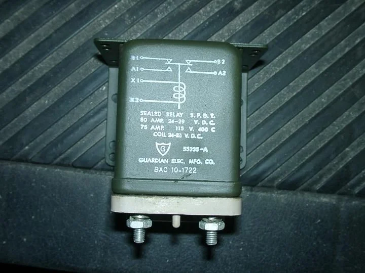

I've been using a miltary relay that is tough enough for Cruiser use. Extremely tough and likely capable of 100A. I have a few new ones in stock for $60cdn plus $5 shipping in Canada.

That's a great relay Bruce...SPDT, and completely sealed and weatherproof. Skinny: Bruce's relay would be a better choice than the Hella HD.

hey is there a NSN # on that relay. I might be able to get into a whole wack of 24v stuff at work if i can get a lead.
That BAC# may help.
