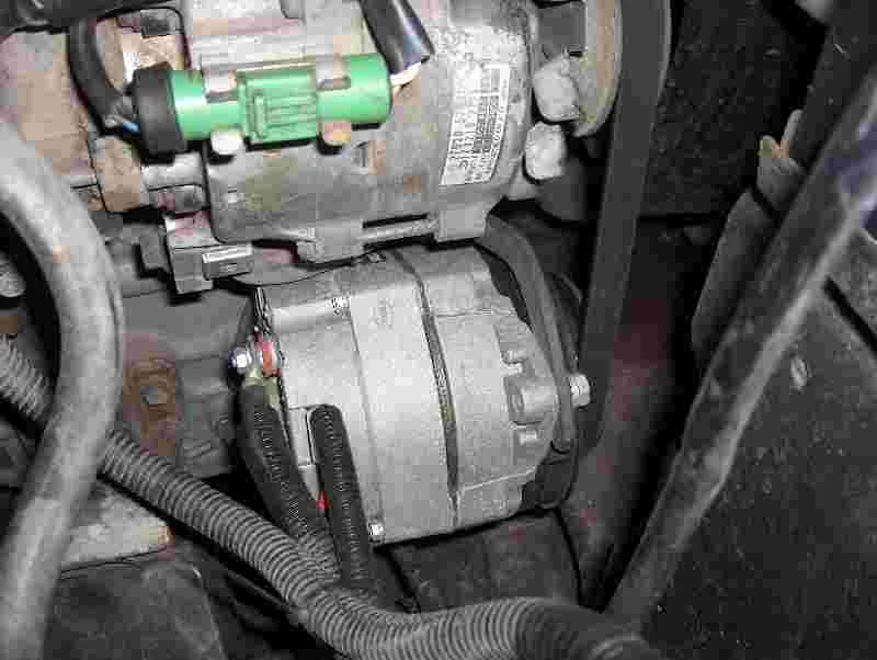

How about 2 Alternators? This a 100amp GM alternator brand new it cost me $100 for the whole setup.

I kinda liked the idea of Dual alternators, but dont you have to have them balanced (IE same output) if you hook them both up at the same time?
Im betting 750amps would run quite a nice winch
Hey Diesel Dude, for the hardpoint on that bracket, did you just drill into part of the block?

TLCA# 11470
Posts: 154
The second alternator will only charge when it needs to it keeps the system charged there is no need for a voltage regulator. As cruiser_guy said I made a bracket that used the A/C mounting spot.
