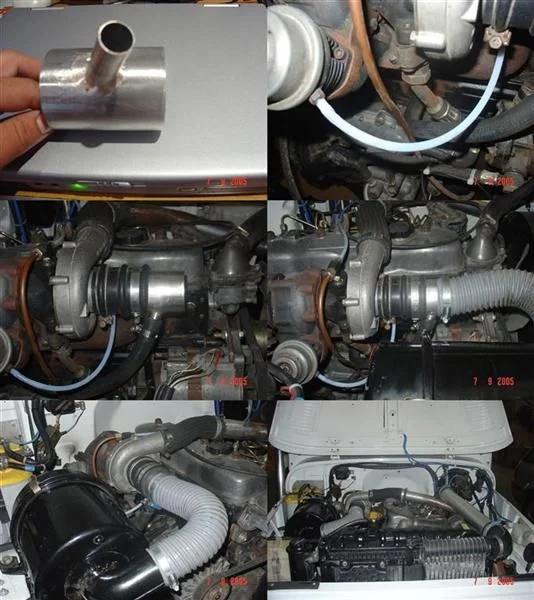

This is how i made the crankcase vent for the 3B engine... So far so good, and NO oil in the turbo, at least for now!
BJ40 3B is offline   Reply With Quote

that looks very nice and clean I might have to do a similar thing there. Hey can you tell me about that intercooler?

Just harbouring a guess, but the end tank looks like the intercooler out of my brother's 7M-GTE supra (except mounted vertically rather than horizontally).

The intercoler is from a Mitsubishi Pajero DID (Pajero in Portugal, but in some countries they have the name of Montero or Shogun).
I had to cut the aluminium connections for the rubber hoses and turn them so they are pointed to the places i wanted and get it welded again. in order to fit the intercooler and oil cooler in front of the water cooler, i've moved the water cooler almost 10cm to the rear and a little to the right (it had to be moved to the right in order to install a 70 series power steering, for me the best power steering application for a 40series using toyota parts).
