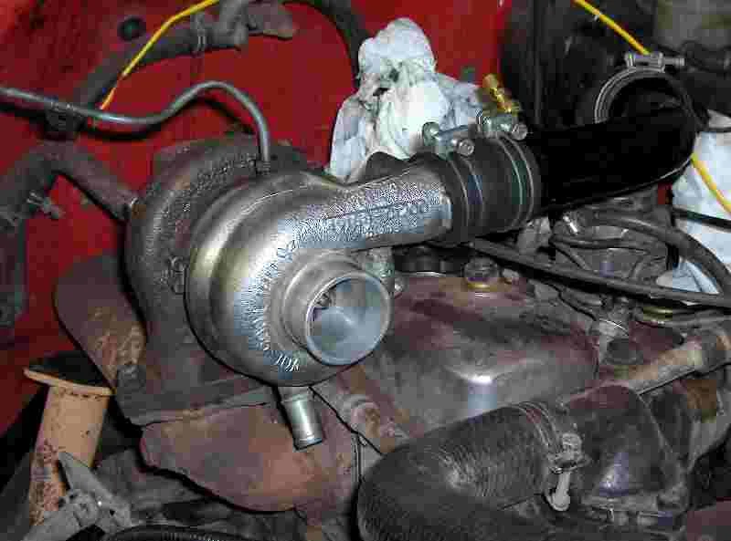

Diesel Dude, have you got a picture of the turbo from the Dodge D-50? Would love to see it.

I have a picture but i dont have a clue how to post it, I would be glad to email it or if some one can tell me how to post it I will.

Okay I got it.

Hard to tell in the pic, is it a flipped manifold set up? How plentiful are these turbos in wreaking yards or availible elsewhere. I don't even know if I have heard of Diesel D-50. Seen the gas ones running around. There couldn't have been too many off them.

The manifold is flipped upside down, I am not sure about the avaiablity I got this one from one of my buddies who owns a auotwreaker as a gift. I checked into rebuilding it when I got it and I do know that the rebuild kit was not hard to find.

how is the performance? it looks like a clean setup, congrates...

The performance is a huge improvment over stock, well worth the hundred dollars it cost me too install.. I dont have any bases for comparision since I have never really been around any other turbo'd 3B's.

Wouldn't this turbo have been used on a 6.3L engine...how does the 3.4L 3B even spool it up?

No this Turbo is out of the D-50(like and s10 or older dakota) not the fullsized truck. I drove this truck when it still ran and i noticed it seemed to have a bit of lag, since it was a smaller motor than the 3B I took a chance and thought it might work. The Turbo spools quite quickly and does not seem to restrict in the higher rpms.

I just fliiped the manifold and the D-50 Turbo dropped into place it has the exact same 3 bolt pattern as the 3B.

Mine is a TC-05 mitsubishi, part no. 49168-01200. I just found this info on Turbo Chargers.com TC05-10A-4CM2 OEM # MD075015 Turbo# 49168-01500 Cartridge # 49168-08020 Repairkit#49168-84100
