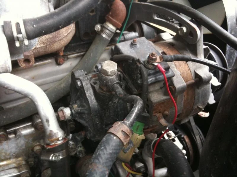

I just ordered a new alternator from Rock Auto for my BJ60 - it is an 81 with the external regular. Well, what I got looks nothing like the one that is in the rig:
More Information for REMY 14339
The one in the rig has a box bolted to the top of the alternator and then a ton of stuff mounted to the back of it. I'm not as solid mechanically with diesels as I am with gassers so I'm not 100% sure what I'm missing on this one.
The one on the truck looks more like the one with the internal regulator:
More Information for REMY 14340
My truck is a hybrid BJ60 + FJ62 so I don't have good info on the donor rig that was the BJ.
Any way of telling for sure which one is on my truck? Sorry for thew newbie question - I tried to search but didn't come back with much. I just want to make sure I order the correct part this time.
Attached is a pic of my alternator as well.
Thanks
Koby

The "thing" on the back of the altenator is a vacuum pump. Diesels do not produce vacuum so you need an alternate source and that is what Toyota did.
What EXACTLY makes you think you need a new altenator? Is the old one not rebuildable? Often the regulator is bad or the brushes are short, both are easily available stateside. I have only had one that was on my trucks that needed rebuilding. I currently have two in for rebuilding (I have a stash of spares just in case) that I bought and do not know the condition of. It will be tough to impossible to find the right altenator stateside for that truck.
I think one of the ones I have in for rebuilding now is like yours.
I could potentially do an exchange on one of mine but I'd need your old one first.
The altenator you need is one from a non-power steering equipped BJ60. That would be '81 or '82. You also need the internally regulated one, not an external regulator. The regulator is under the cap where the red wire is attached.

That's right, none of the altenators you posted links for is the right one. I suspect they think that the FJ60 and BJ60 use the same altenator, they do NOT!
