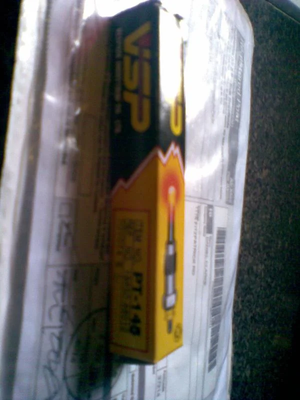

OK guys, just finished installing my new VSP 10.5v glow plugs.
Glowed for about 15 seconds and still smoke

Here is a pic of the plugs I installed ... sorry for the low res - taken with my phone
Checked each plug for continuity and they all check out OK

Been following thread with particular interest. I to suffer from the "smokey starts" syndrome.
I decided to pull the plugs and check for continuity when I noticed something strange... 3 plugs were 14 Volt and 1 was a 20.5 Volt plug!!! Continuity was good on all plugs.
I do believe the 20.5 volt is the proper plug for my truck - how did the 14 volts survive? New plugs will be next order of business!
I have the SuperGlow system with intial click producing 22-23 Volts for 5 - 10 seconds and then drops to 12 volts or so 20 seconds.
Thanks for the good reading!

I have several 24 volt trucks, all HJ60's, and 14.4v are the ones that are supposed to be there for the superglow system. From what I have tested, 24 v is delivered for about 5-6 seconds then the timer kicks and you have 12 v for the next 20 seconds.
I don't know if your BJ42 is the same system though.
