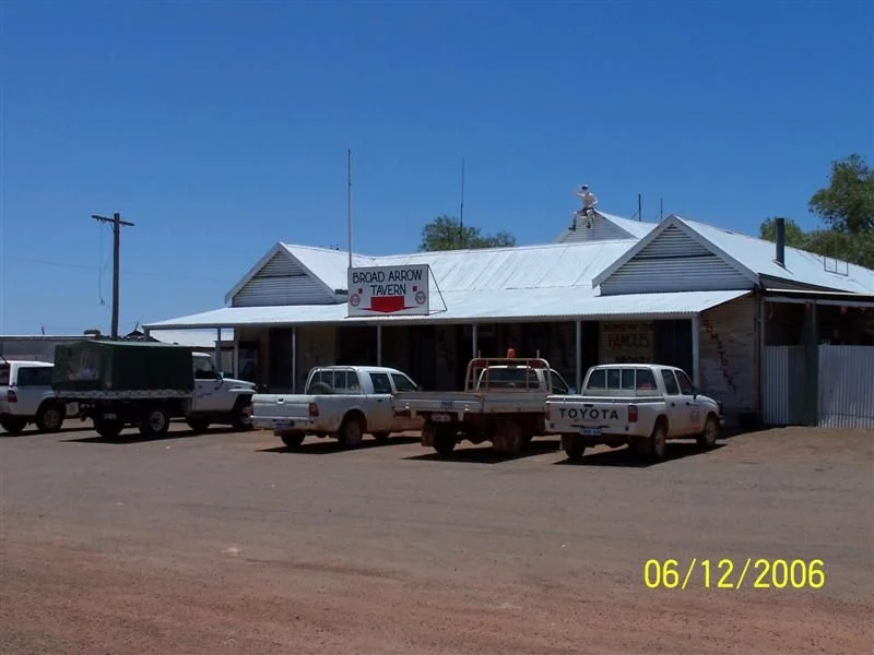

They use them a lot in the gold mines here as general purpose runabouts. They re good for 350000+klm.
This pub is right next door to a gold tailings operation, so they come here at lunchtime in the Hiluxes
Thats my 75 in the middle.
