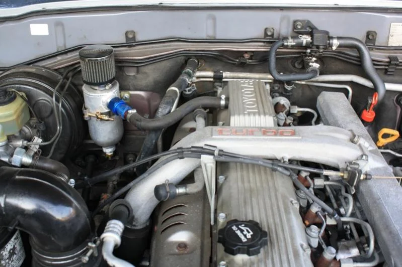

Just a lil bit of my experence here, take it as you will. If you are getting a bit of blue smoke and not burning any between changes, your beating your head against the same brick i was. I would get large bluish clouds specialy for the first 5-10 km every morning, as well i noticed oil driping onto my front diff that looked like it was coming from the turbo. I figured ....great turbo seals are gone. After further inspection (after dealing with it for 6 months) i found that the blue was indead coming from oil and yes it was going through the turbo but the turbo was not the problem. The problem was the the crank case vent. Under normal opperation since these motors are "enviromentaly responsible" and re-burn there blow by gasses through the intake pre-turbo rather than vent it into the atmosphere like older normal diesels, they slowly slober small abounts of oil into the air filter suction tube before the turbo. When warmed up and running its not as bad , but let it sit over night and even if it is 0.05 of a liter or just oil residue runs down the tube and sits in the turbo housing. This (on mine at least) caused it to look like my turbo was leaking and when you started up in the morning and got on the throttle, the turbo essentialy attomized the oil with the air charge and created a fogging effect of blue smoke.
After looking into a couple options, Racor had a very nice system called a CCV system (closed crankcase ventilation) that separated the oil from the blow by gas, returned the oil to the crank case and returned the "clean" blow by gas to the intake . This system was to rich for my blood at 350$ So i opted for a MORROSO vacuum oil catch can. This can still separates the oil from the gas but it vents the gas into the atmosphere and holds the oil in a can for you to drain.
My truck did not exhibit any oil loss between 5k change intervals, so it goes to show you how little oil it takes to create this problem. As i said before take it at face value, this was just my experience and it had rectified my oil drip and smoke problems 100%.
9180ltd is offline   Reply With Quote

pic didnt stick!

9180ltd:
what model MOROSO vacuum oil catch can did you buy?? They got quite a few here:
Moroso : Category Display
Cheers

So the vapours are just vented under the hood via the airfilter? I thought they are somewhat corrosive and contaminating. Why not vent them into the intake post turbo?

you would need to be pushing a lot of crankcase pressure to exceed turbo pressure, wouldn't you?
even with a check valve, it seems dodgy.
I think that is why they go pre-turbo in the stock configuration, that's the closest thing to "vacuum" that you find in the intake system.
if you filter the oil out of the crankcase vapors, it should be pretty clean air. Maybe traces of unburnt fuel, but only traces.
This is a guess. I don't know the answer.

The can has a series of baffles on the inlet so i have found it dose a better than expected job of separation. As far as corrosive it would be the exact opposite....... were filtering different oils here. I thought about re-routing back pre-turbo but believe it would limit the amount of separation that could take place with the turbo basically sucking the gasses faster than the oil vapors could fall into the can. After all we are talking vapors here, that said only accumulation causes problems. If any thing i will take the filter off and run a tube down beside the frame and let the "clean" vapors vent onto the ground like all the other diesels (older cummins, cat, izuzu, toyota etc.)
I'll have to check my bill for the part ## , I bought it from Mopac in Langley if that helps anyone but any high performance auto parts store that carries morroso should have it (from what i remember it was a common one)

By the way , i have had this system hooked up now for about 10,000km and as far as the contamination goes i have had none. The filter sits about 2 inches under the fabric acoustical mat under the hood and there has been no saturation or discoloration what so ever. I have even done oil sampling to assure no condensation was entering the valve cover via this system , and there was none.

as for corrosion: I'd rather have "corrosive" air hitting my firewall than have corrosive air w/oil and gunk hitting my turbo.

I made a catch can out of an aluminum water bottle with copper dish scrubbers inside. It is going back to the intake pre-turbo like the stock routing. It seems to have helped with the blue/gray smoke I was getting.
