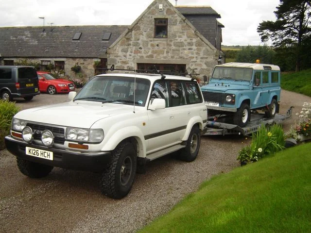

Whats with the ridiculously low tow limits suggested on this forum? I've no real experience with auto cruisers but for a 5 speed 1-HDT 7500lbs is probably a more realistic max limit. Even my Audi A6 tows 4000lbs quite comfortably. The auto 80 is rated for the same 7700lbs as the 5 speed over here and I can't imagine Toyota selling them if they weren't up to it?
I regularly tow in excess of 7000 lbs all over Scotland and although we may not have grades as long and relentless as you guys, the roads are certainly as challenging if not more so.
Although I've posted this before, I towed this rig 600 miles with no issues, only slowing from a steady 60mph on steeper hills. There was also 6 people in the cruiser and a load of stuff in the Land Rover.
