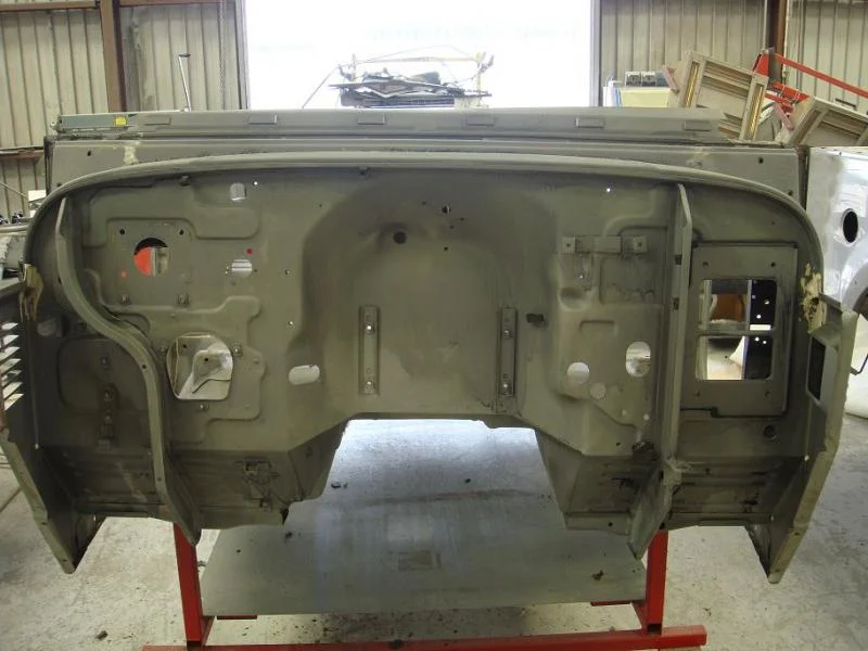

Old 07-10-09, 07:22 PM   #61 (permalink)
Site Addict
Roberto's Avatar
Join Date: Jan 2007
Location: Lumberton, NC
Posts: 1,829

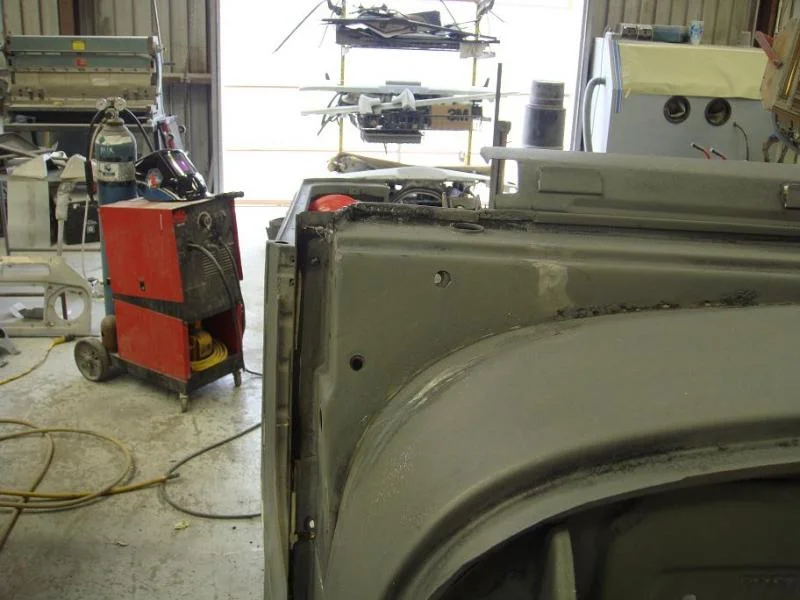

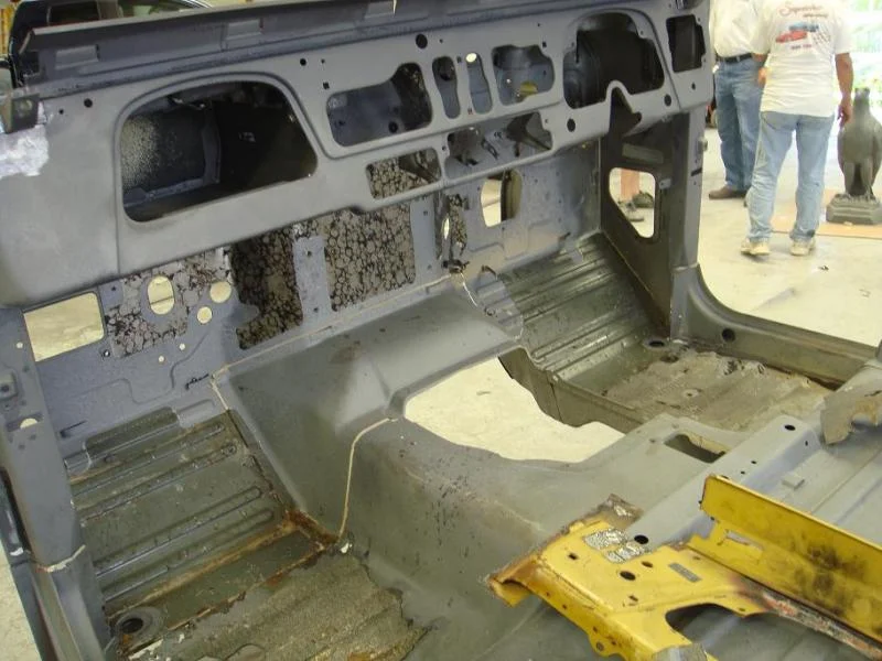

body shop pics
went by body shop to see progress, they already replaced the rusted windshield hinge area with the donors I bought from SOR, worked out perfect. They sprayed the whole sandblasted body and parts with some oily stuff to prevent from rusting while they cut and replace steel prior to priming. I am working this weekend to tear down top to take to them next week. I have new CCOT gutter system in which I will have them put on weld it and then rust bullet it before putting back on.

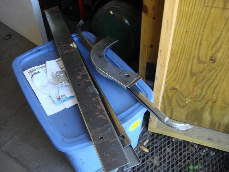

pics

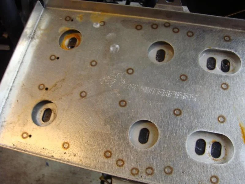

pic of stainless battery trays, doors stripped ready to go to body shop along with new CCOT gutter system to be put on after they rust bullet it!!
R

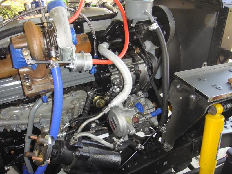

Old 07-11-09, 04:29 PM   #65 (permalink)
Site Addict
Roberto's Avatar
Join Date: Jan 2007
Posts: 1,829

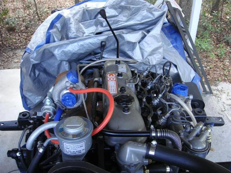

more pics
New P/S pressure hose installed, pics of stickers from AATLAS,

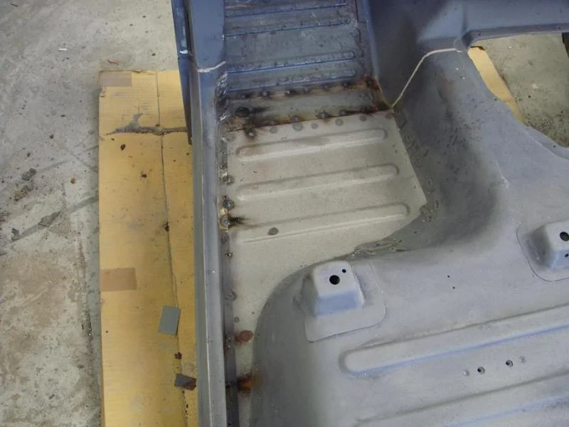

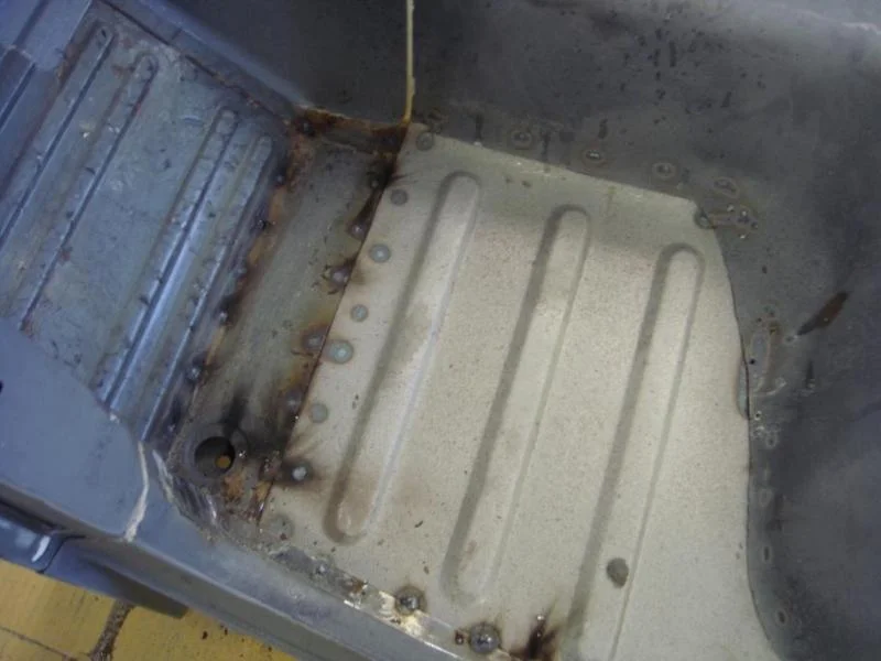

__________________
06/1983 RHD Turboed BJ42 LX, Triple wipers, P/S, A/C, 5 spd H55F, ARB Lockers, factory 6 seater!
CDN M101 Military camping trailer w/ RTT
Roberto is offline   Reply With Quote
Old 07-12-09, 05:36 PM   #66 (permalink)
Site Addict
Roberto's Avatar
Join Date: Jan 2007
Posts: 1,829

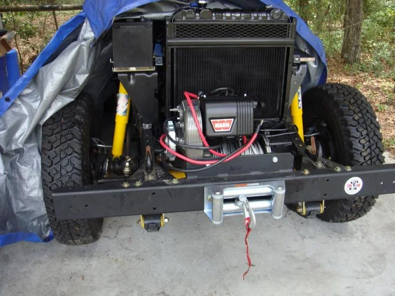

winch installed
winch installed, Heavy son of a ?
R
__________________
Old 07-13-09, 09:48 AM   #67 (permalink)
Site Addict
Clint79's Avatar
Join Date: Mar 2009
Location: Perth Australia
Posts: 1,107
its looking very nice and shinny mate top darts
__________________
J7
Clint79 is offline   Reply With Quote

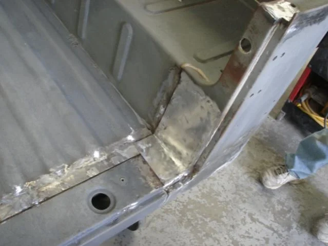

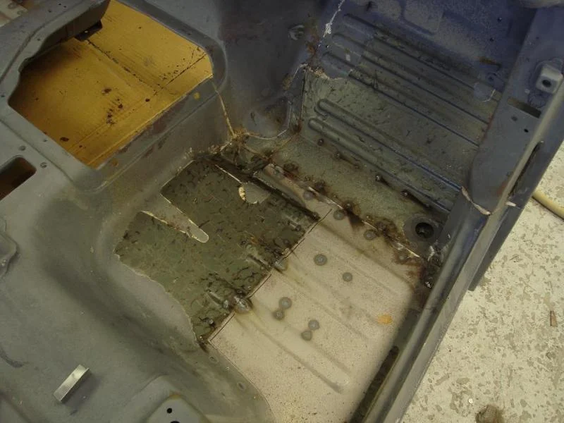

Old 08-03-09, 06:06 PM   #68 (permalink)
Site Addict
Roberto's Avatar
Join Date: Jan 2007
Posts: 1,829

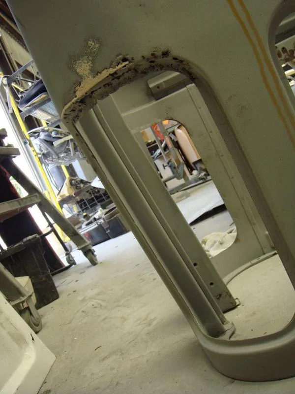

more pics

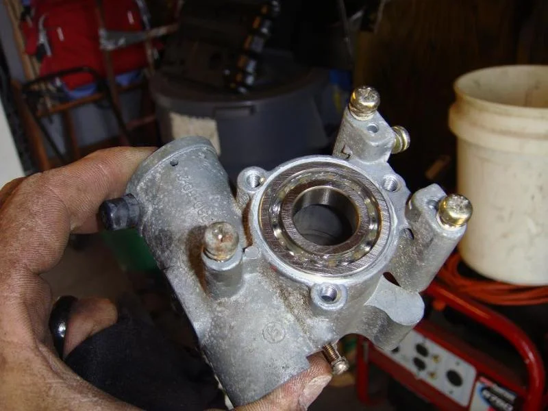

floor pans and other areas cut out and reinstalled new. new bearing in upper steering column

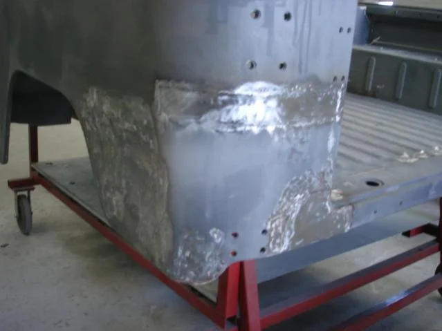

Old 08-03-09, 06:08 PM   #69 (permalink)
Site Addict
Roberto's Avatar
Join Date: Jan 2007
Posts: 1,829

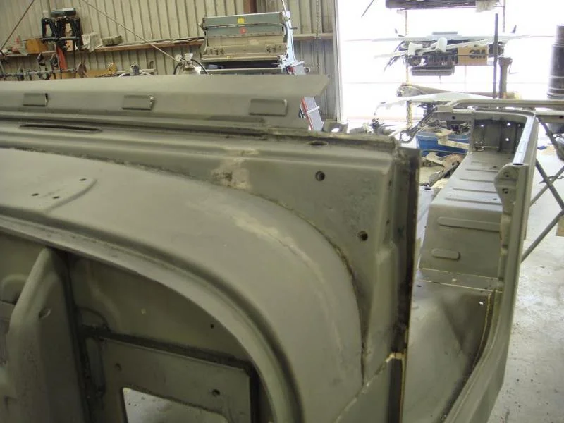

more
metal areas replaced in rear

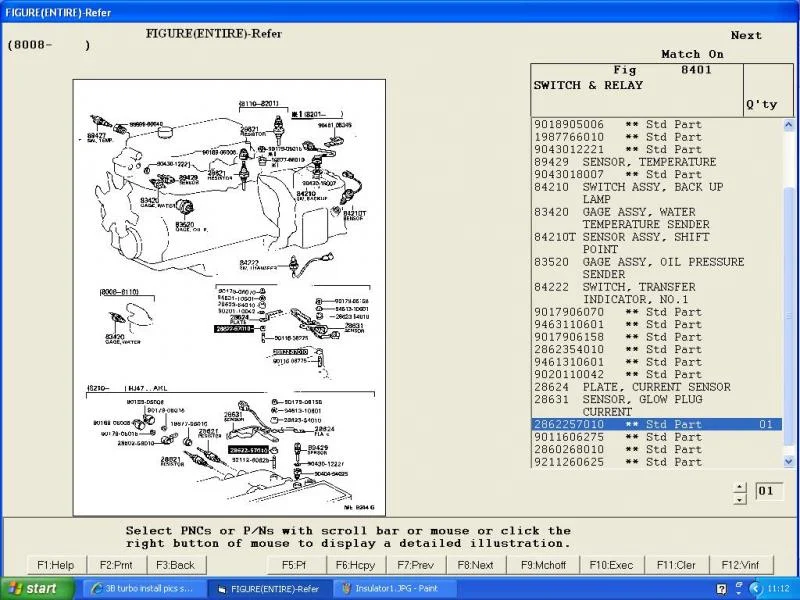

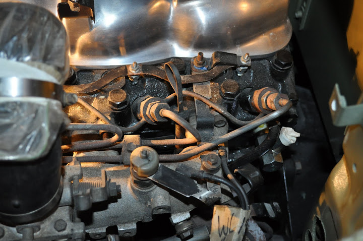

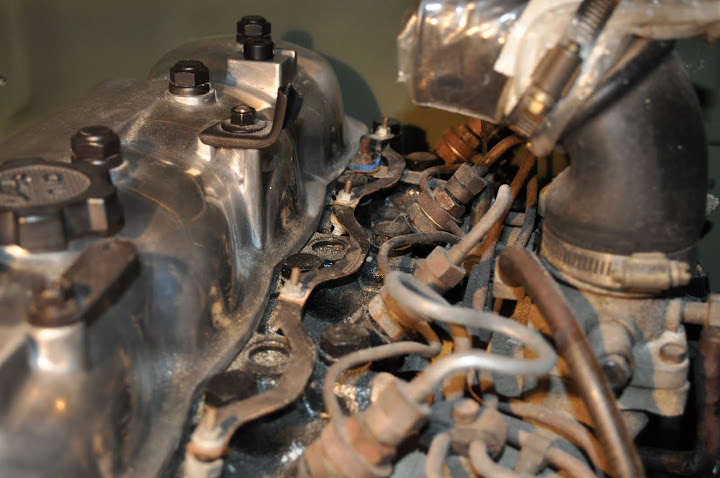

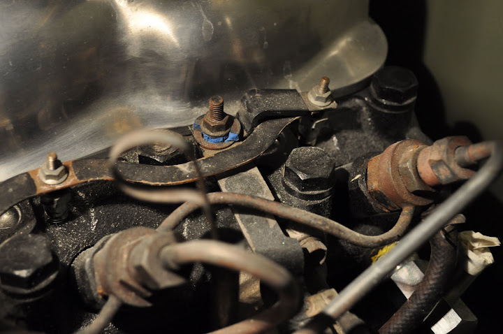

Ok Rob, I hope these show what you are looking for. If not just shout and I will snap whatever you need
Hopefully somebody can tell me what the part or #no for that broken blue fibre-type washer/isolator is ?

Thanks a bunch Theo, I appreciate it, I will try and find something similar to those bushings.

Quote:
Originally Posted by tmarx View Post

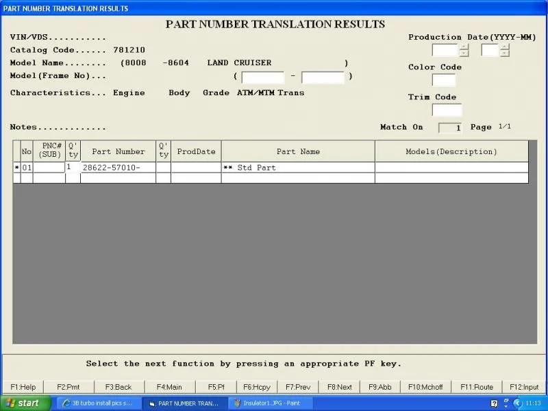

...Hopefully somebody can tell me what the part or #no for that broken blue fibre-type washer/isolator is ?
Does this look right Theo? (Very hard to tell from the small image on the EPC.)
Part number 28622-57010?

Thanks Tom ! You never fail to surprise me. I will use that no to see what we come up with. A buddie of mine is currently rebuilding another friends B motor and I sent him that pic. Even though we never got any of the B series motors in ZA, he reckons he might have had one of those in his shop and will get back to me.When he does I will report back. I suspect it might be a case of the B ser engines having the same parts as the 2.4L motors again ..
Edit: And from toyodiy.com it looks like you are correct, as usual http://www.toyodiy.com/parts/diag_ARq5uY.png
Edit x2: On second thought it actually looks more like 28623-54010 *** STD. PART $2.64
Exactly the same as for the 3L(2.8) engine which means an easy find in ZA for a change and no waiting 6 weeks ex Japan !

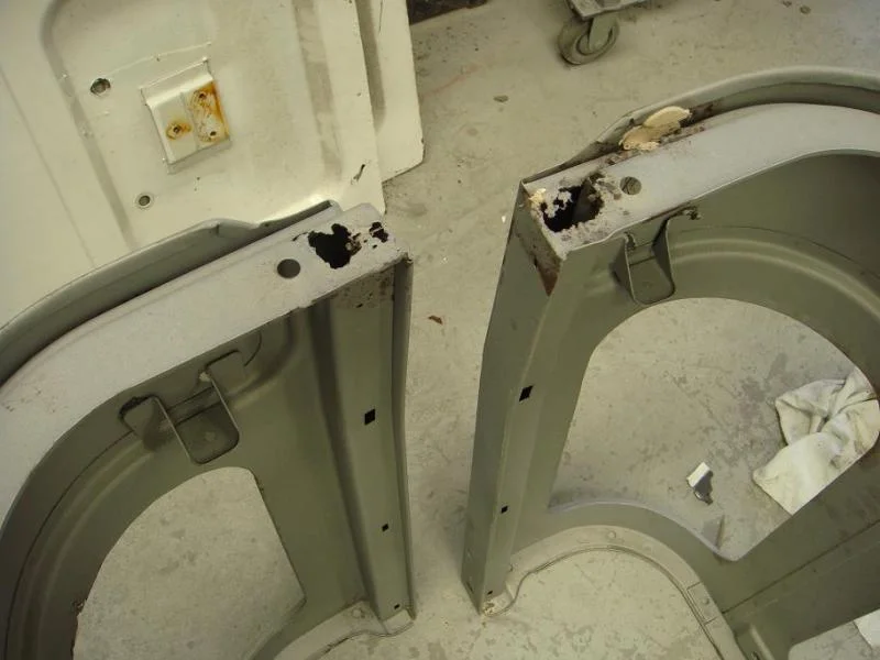

Old 08-10-09, 05:36 PM   #82 (permalink)
Site Addict
Roberto's Avatar
Join Date: Jan 2007
Posts: 1,829

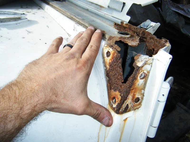

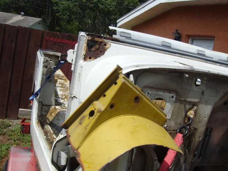

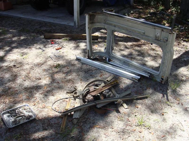

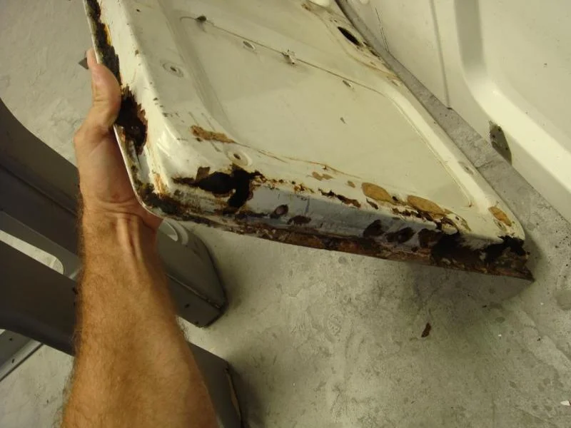

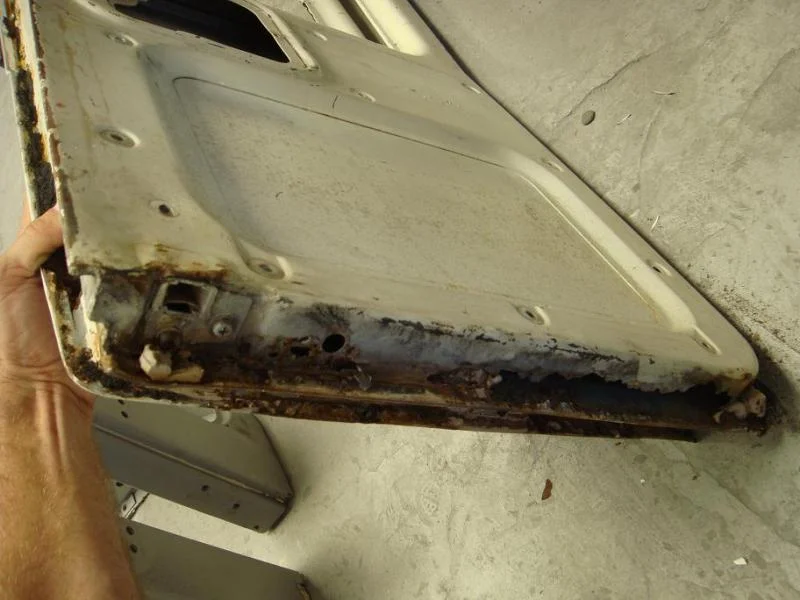

just more pics of unwanted rust in which I bought the fix for from CCOT. the hardtop pieces will be custom fabbed. Since I could not source the rubber weatherstripping for inside tracks of LX side sliding windows I am going to see if the ones I bought from SOR will work in which they are the same length and height? They state they are for 76 or older cruisers but measurements tell me they should fit so my fingers are crossed?
R

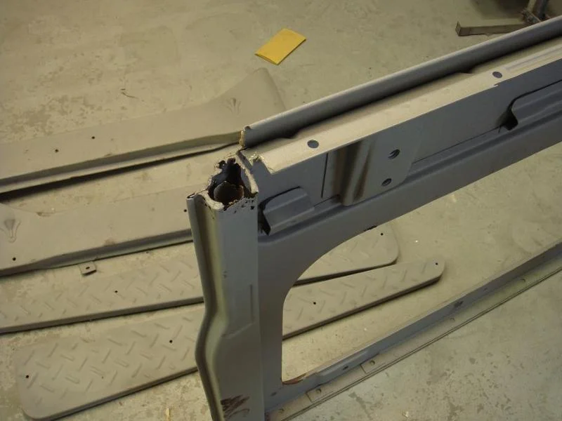

more pics

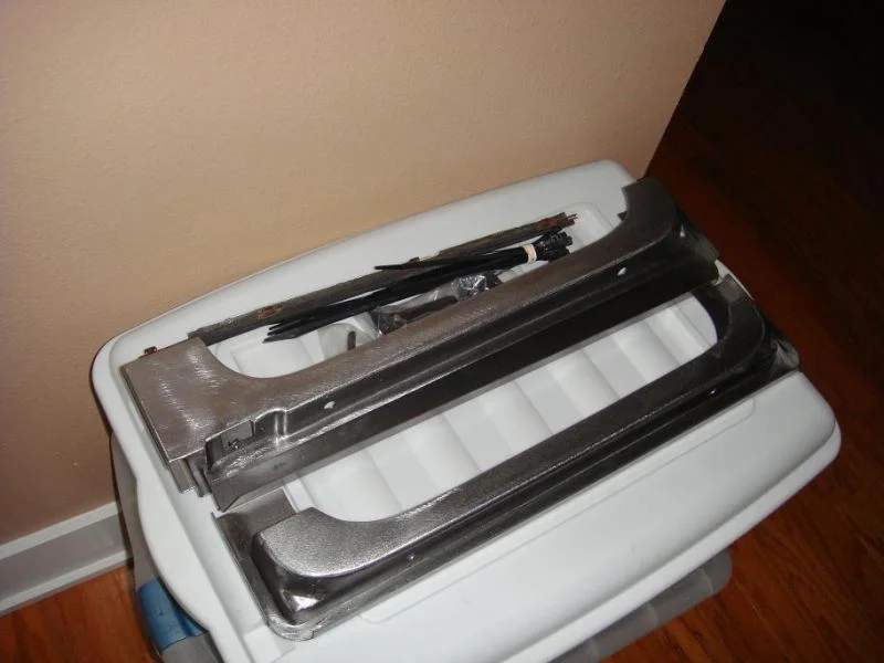

last one

Here are those promissed parts Rob.
This one goes at the top
and this one underneath ..
Today I discovered that whoever replaced the ones on my vehicle in Aus, had mixed them up and fitted the wrong one at the bottom, which kinda explains the reason why it was crushed ...

I haven't read any of the posts, but was merely looking at the photos....
The lines that run from the "throttle body" to the injection pump should have clamps put on them or they can blow off with the turbo.
Make sure that your diaphragm is in good shape as well.
Your work looks to be very nice. I bet you have 100s of hours into that.

Radd, which lines are you talking about? in what pics?
R
