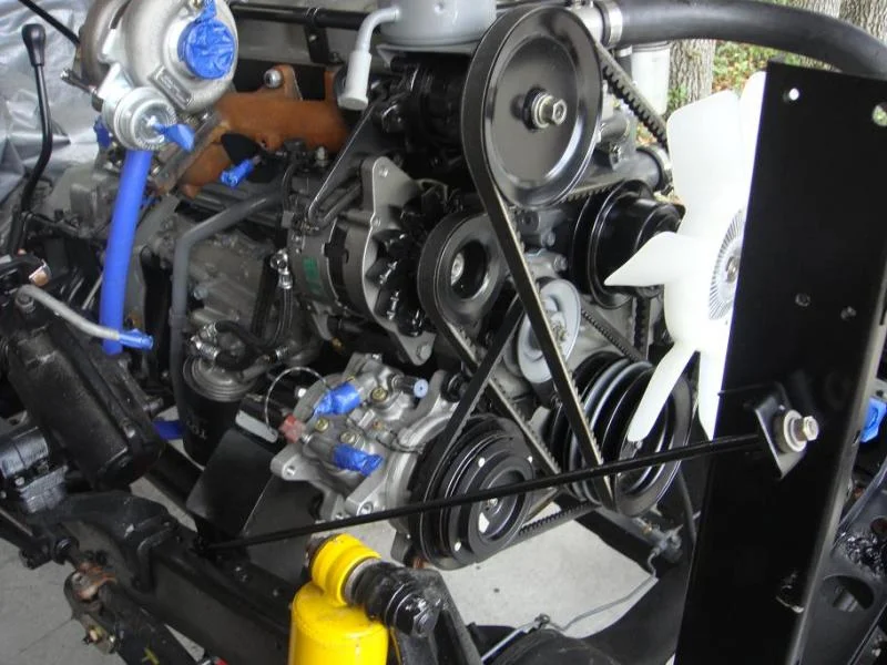

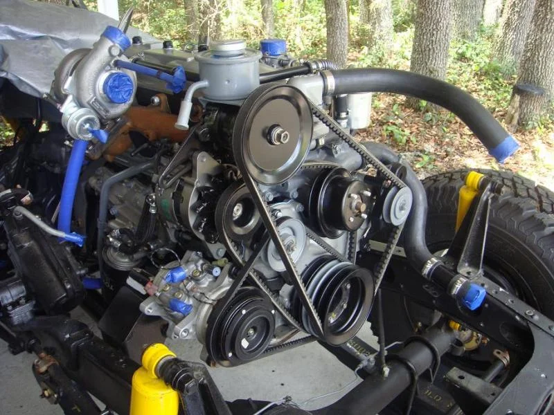

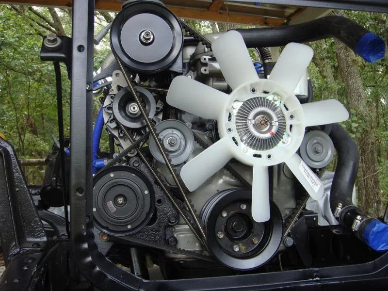

Got belts on
Got alternator rebuilt, put in new oil seal, bearing, diodes, brushes in it, along with new rotor, new oil pump gears and brushes. Got belts on, went to put on new fan clutch and since it was aftermarket it did not line up with OEM fan blade, so 4Wheelauto is taking back and I just got my new OEM fan clutch so will go on next. Took me awhile to figure out belts, I had the idler pulleys on wrong sides so had to switch with each other.
R

I have a few parts you may want to make this a cleaner install. They are parts from Diesel42 and My new B Series Turbo Kits.
The parts I have are 45 degree angle 1/2 NPT to 5/8 hose barb that allows you to clock the drain line at the turbo to a higher angle and get the oil feed line to vertical as is recommended. You can use it at the oil pan bung too to get a more vertical drian line. I also have a 1/8 BSPT to 4an (37 Deg JIC) fitting so you can use only one fitting at the oil galley to the line. No adapters or t's.
Let me know if you are interested. I think it would be around $15 for the parts plus shipping but will make for a much cleaner (if yours could any more clean) install.

That return pipe to your sump cant get mashed by the diff or front shaft? a mate put a turbo etc on his 1hz 80 and not thinking about the surroundings when he put it in a bit of the front diff or shaft cant remember when 4x4ing come up and bent it on flexing?

I hope not, I will only be doing light camping and stuff like that even though I built to much higher standards. Heck I dont want to even drive it in a mud puddle when I get it rolling, lol. If it was to flex enough to hit that then it is going to take out my oil filter as well form the looks of it. I will keep fingers crossed. Thanks

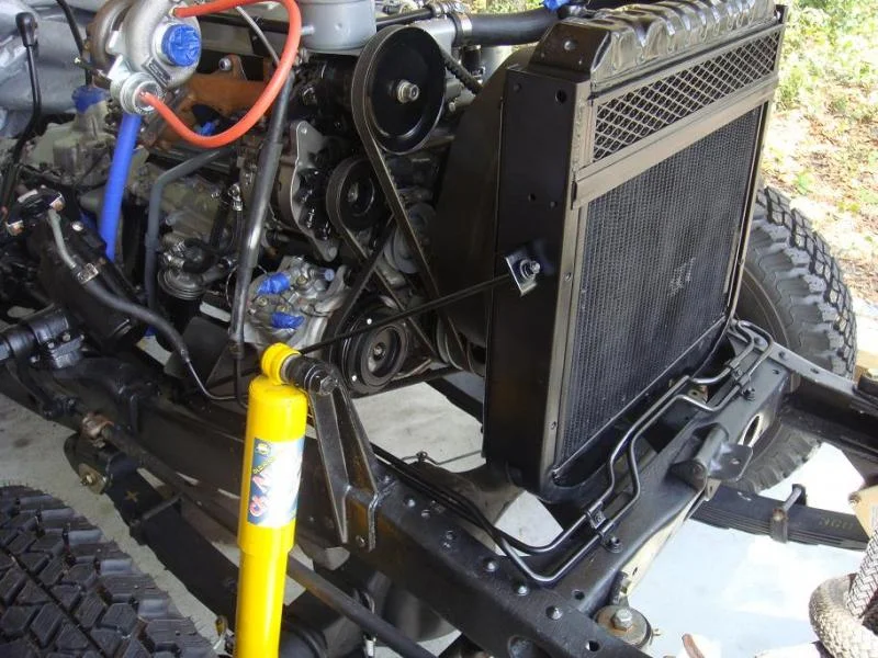

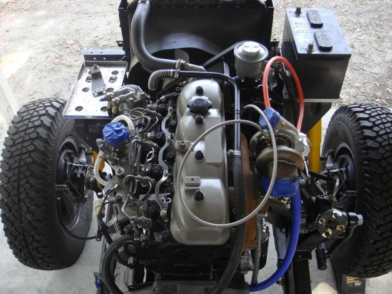

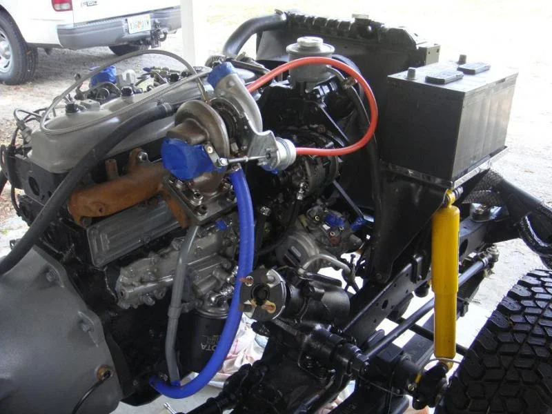

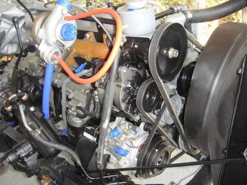

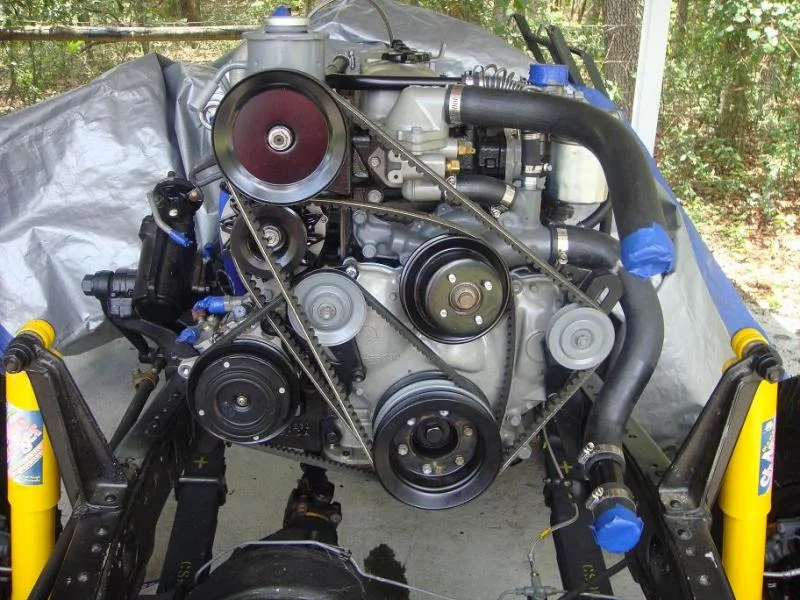

more pics
got the OEM fan clutch in and on, belt tightened, radiator on and hoses attached to include lower radiator hose heater, will go through today and tighten all fuel componenets to specs and prep and paint P/S cooler lines and attach to frame

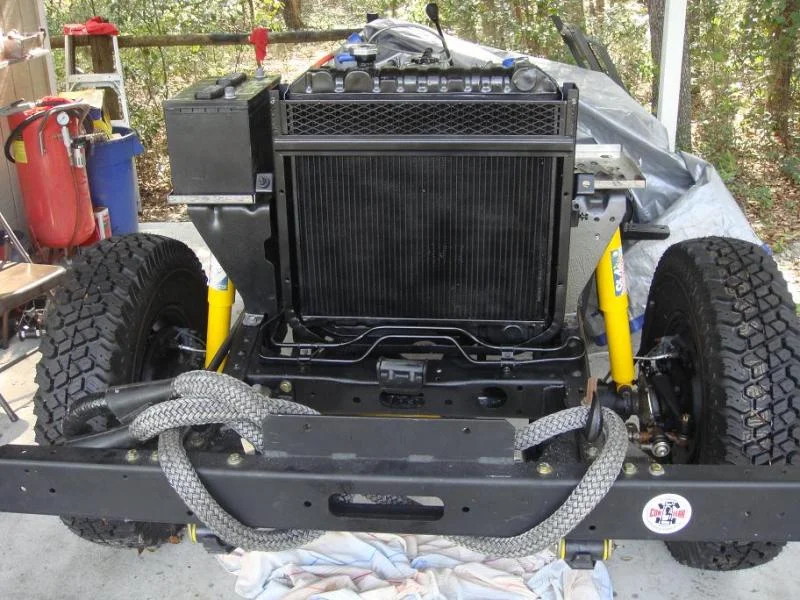

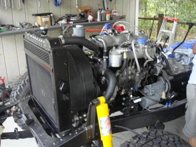

more pics

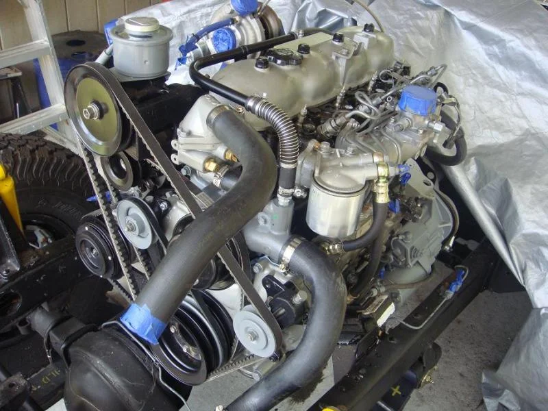

installed P/S cooler lines, battery brackets, P/S pressure lines, venturi lines, edic motor

Thank you brother, the turbo orange line is just hanging around before I cut the appropriate length, as well as the heater hose. I am going to get a new P/S pressure line and I was going to ask you on galvanizing your rims, was there any problems with the ring afterwards? I am thinking of doing same thing?

in post 37, the last pic. The starter has a space between it and the bell housing? It should be flush.
AWSOME job so far dude, she looks beautiful.

thanks brother! there is no space, thats a black metal plate to keep mud and junk from getting up in there?

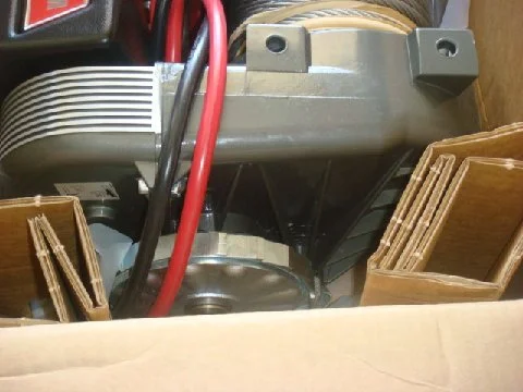

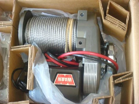

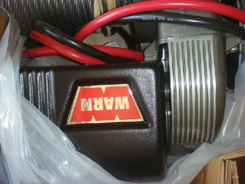

Oh yeah, looky what UPS brought to me today!!! Shipped in 3 days...Going to get synthetic line from Viking offroad.
R

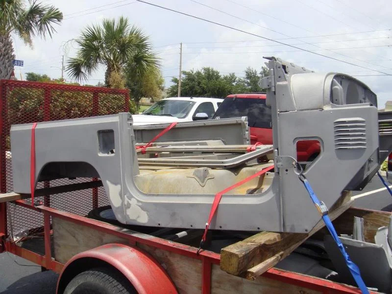

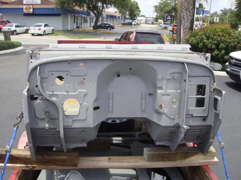

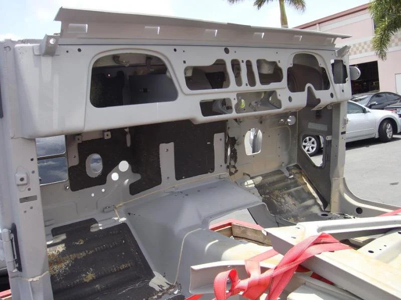

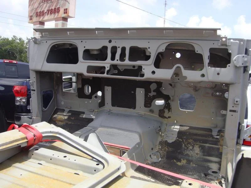

Body back from sandblaster

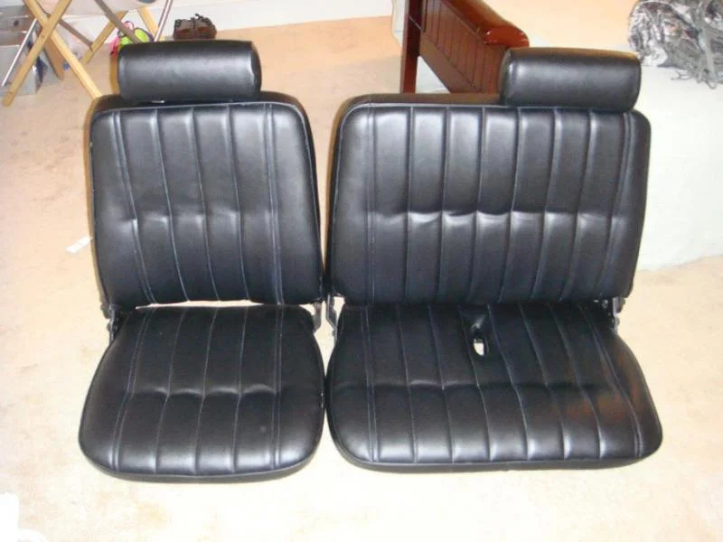

Just got body and parts back from sandblaster, dropped off to the body shop afterwards in which they will take many of pics during work they will do and I will post.
R

pics
1 more

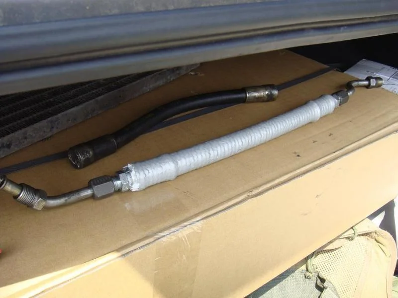

Had new P/S pressure line made since Toyota no longer has them. My old one was rotted, went to local hose company who makes high pressure lines, $25 made it 2" longer for me and put this rubberized heat shield around it. My old one is behind it, they made it to same exact specs as OEM.
R

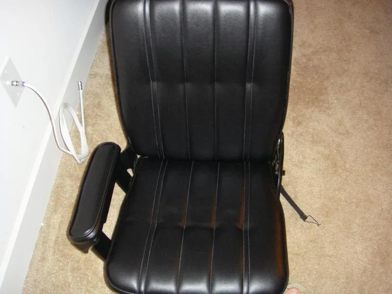

got seats back from being redone
black vinyl

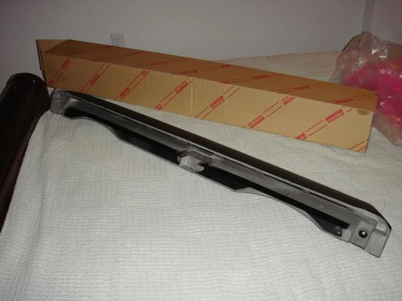

new dash pad
my old dash was cracked up a bit
