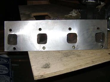

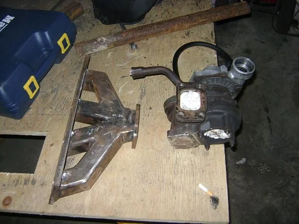

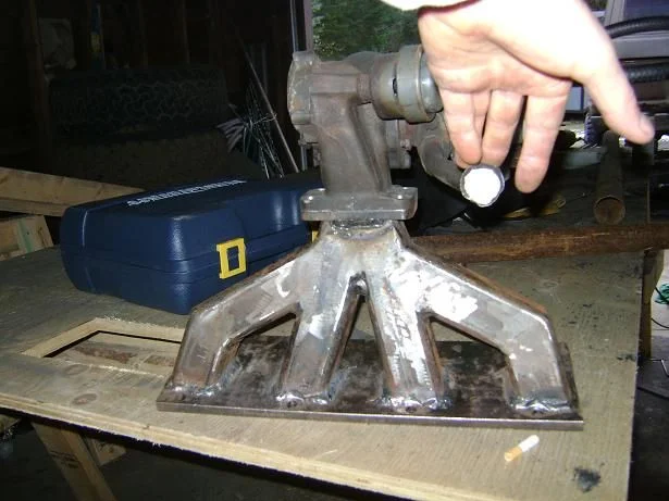

well this is my manifold, what do you think guys. heavy duty? 2x2 1/4 wall square tube with a half inch plate. i got this turbo from an old mercedez 5 cyl 3.0L. pretty close match to my engine. anybody use one before? just waiting for some plumbing parts to hook it all up. will keep updating.

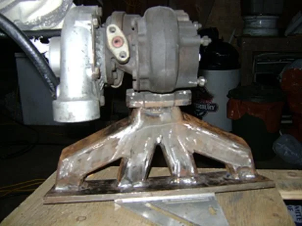

more pics
air research turbo, i heard they're like a t3 but???

Cool - did you weld the wastegate closed???

I like it, nice and simple layout with good direct flow.
You going to have it coated?

i'll have it coated with the cheapest high temperature paint i can find. go big or go home. go cheap or get a job.

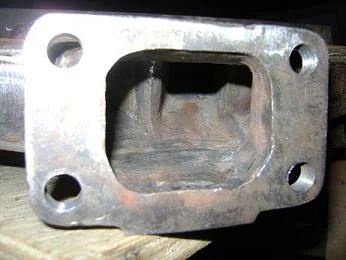

got it freshly shaven. it warped out on me a 1/16th when i was welding it. 80 bucks straight up from a machine shop.

The manifold plate seems to have bent due to heat, maybe you should have it machined.

heres the fresh shave
and the tunnel. they're pretty skoocum. have to get sum kind of wheel on a drill or??? to clean up sum of the slag

yes i did, the bolts holding the plate all snapped, yes i coulda got the heat out and all but that woulda taken 5 minutes

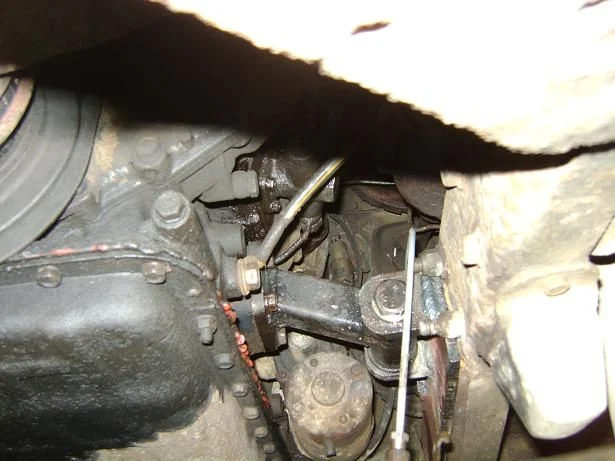

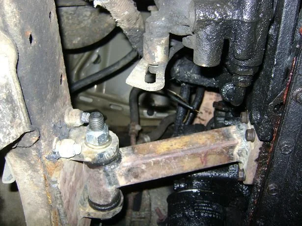

heres my new engine mounts
buil;t them for $50, beats the 300 they wanted from toyota. i warn you this might make your truck shake a little more.

Posts: 237
looks kind of scabby

Old 03-09-09, 03:17 AM   #13 (permalink)
250+ Club
Ron R's Avatar
Join Date: Dec 2006
Location: The Netherlands
Posts: 724
I can beleve they are less costly then Toyotas but do they last as long?
Guess you will be finding some cracks sooner or later, probably sooner....
Would inspect the edges of the welds on a weekly basis to start with......

SCABBY?? take a close look at your truck

mmmm tractorfab.... if it does the job, it's all good.. tho I think your engine mounts may be shortlived ...

Yep i don't think the support will last, how come you don't have the mount brackets on the engine? and tight that crank case cover.

if was dealing with a gasser engine .. they will funtion .. but the vibration from any diesel will kill 'em .. but that's just my thought ..

you will end up either cracking your block or break the frame or welding with your mount setup. Also, your manifold will expend by some 30% in all directions once you reach 1000 f or so.
I guess you forgot to calculate that expansion formula when you used a 2x2 soft metal.

30% 39% 30% hah...... according to the 30% theory, a manifold that is 12" long would grow to over 15.5" long when heated to exhaust temps... I think not..... now back to reality...
Moulds used for making aluminium castings are about 2% larger than the finished product (including machining tolerances). So if your casting an aluminium part 12 inches long the mould would be about 12.25 inches long. So that's going from a moulten state to a solid room temp state.
I see your exhaust manifold appears to be mild steel box section, so it's expansion/contraction will be less than 2%, I actually don't think you'll have a prob with it, though original cast iron manifolds sometimes even crack... if it does crack, just weld it back up or cut down a panel of the neighbours fence and make a new one.. easy
ps... Cruisedeisel, you really should change your name to tractorfab... keep up the good work..

Man those engine mounts are awesome. I would like to have you around to do some welding on my frame. Just the same…I would get some rubber in there somewhere. Just the startup alone is gonna put a load of torque on those mounts. I don't think they'll break, I just worry about the engine.
