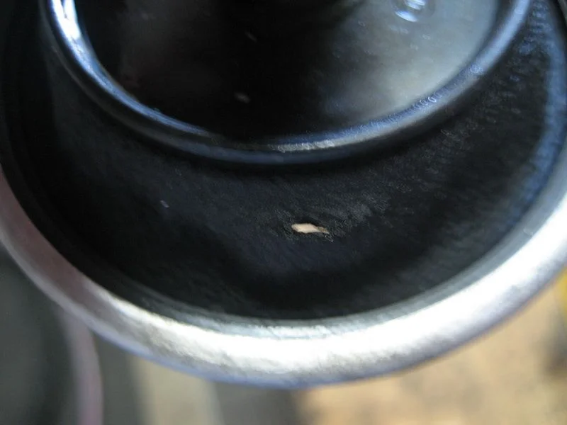

Replacing the Diaphragm
Have you done it in place without moving anything? well except the EDIC arm? if you are part of that Elite, BE PROUD. lol took me 2 hours, 6-7 retry to get the 8mm nut back on, but oh boy i did it.
Tinny hole....

Did it all with my fingers! i mean get the diaphragm back there and screwed the nut! I did cheat a bit by greasing up my fingers ;-) so the small lock washer and nut would stick.

Yes, the truck was running 1000 rpm instead of the usuall 700, and it did fix the problem. At first i couldn't find a hole in the old diaphragm, but after stretching it, i did find the one you see in the first post.
