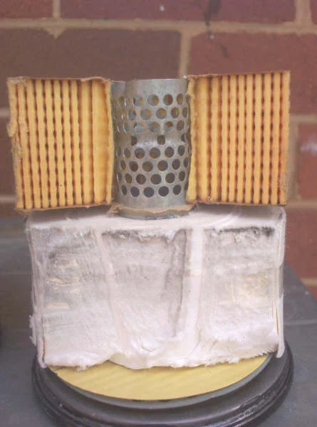

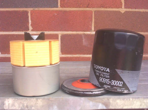

According to Caterpillar, Donalson, Cummins and Fleetguard - duel eliment filters are not the latest and greatest. - or more equiptment manufacturers would use them. I ask every time I do a course. They are an old tech idea - having half the filter with infereor filter medium.
What would you put better oil filtration on? - a car with service interviles by the km, or a gen set that powers a town, or a ship, or a hospital, or some mining equiptment that costs thousands every time you pull it up to service?
What other vehicle uses them?
The 1VD? - no - and it has a 20 000km service intervile!
