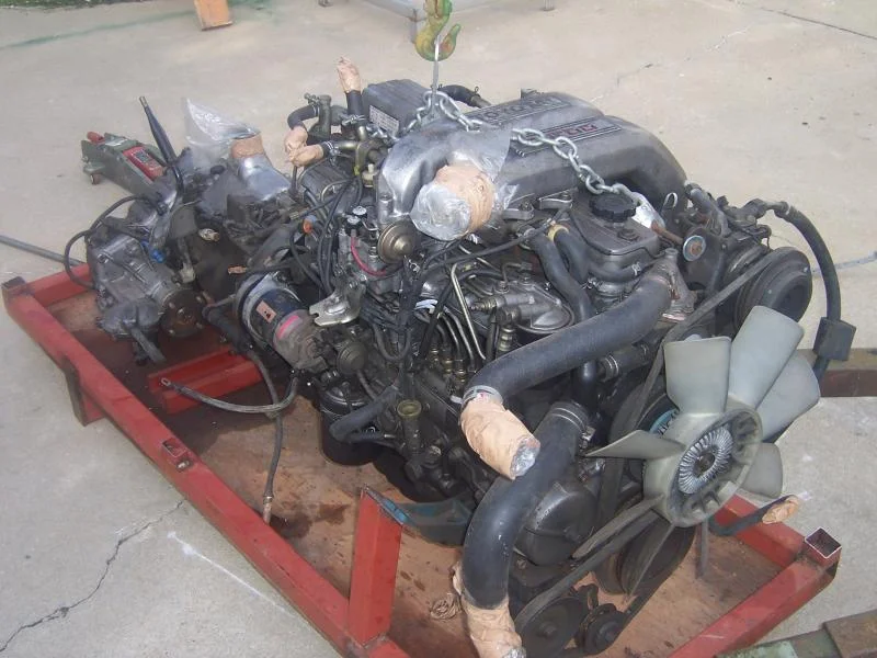

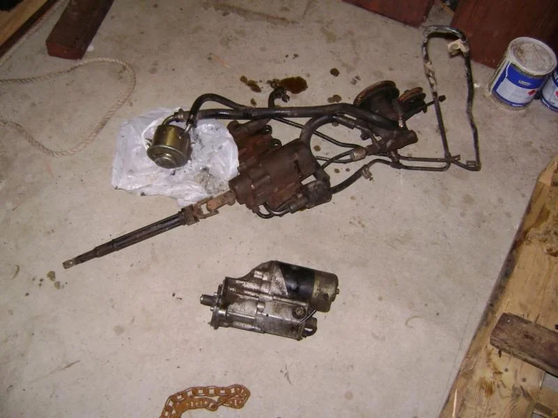

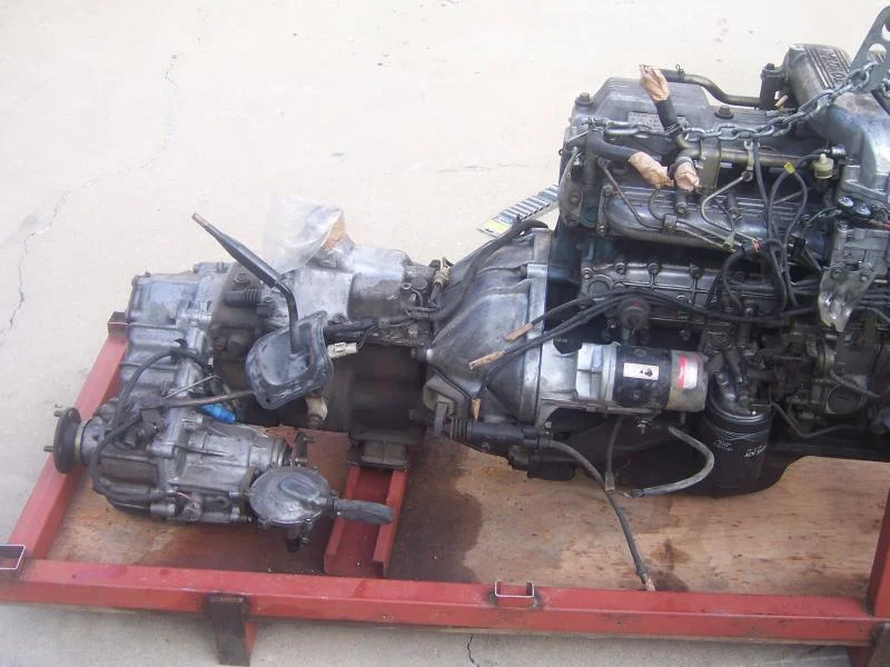

picked up a 12ht. Questions
going to be putting this into an87fj60. notice that the power steering pump is close to the passenger side motor mount. where does the resorvoir mount to? going to be having alot of questions. looking forward to responses thanks

let me know if these pics are the right size. first time loading pics. thanks Anest

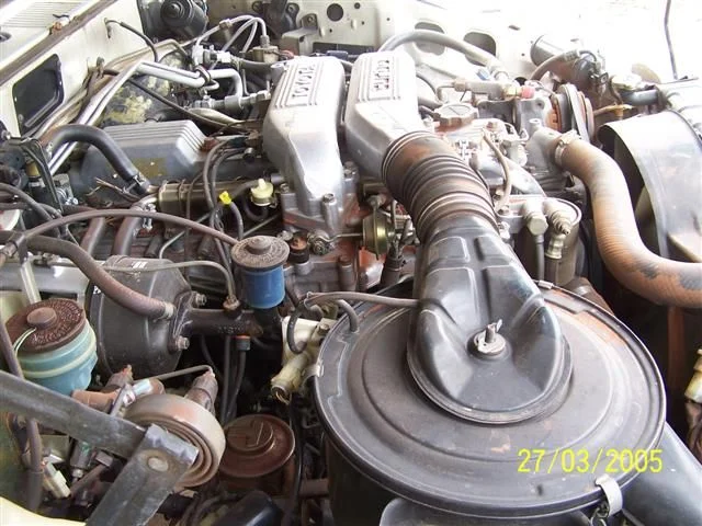

Hi, nice combo, You can mount the resorvoir on the inner fender, like on the BJ 74 series.

Down on the RH side on the Aussie models

could i use my resorvoir of my gas engine?

I dont see why not.

not trying to sound stupid but what do i need. how do i mount the resorvoir to the fender. and what kind of lines to the pump?

Most cruisers have a few spare holes on the inside of the fenders with thread in them. You just need to fab a bracket and bolt it to the sides adjacent to the pump..
For the fluid lines,they are non pressurised to the reservoir,so you could use any fuel line with a big enough diameter. I guess they woud be about 10mm inside diameter.
The upper spout in the reservoir is the return from the steering box. The bottom spout feeds the fluid to the pump. If you understand how your gas PS works ,you can just extend and plug the new hoses into the existing system.

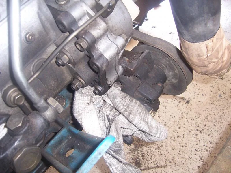

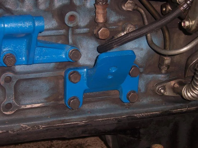

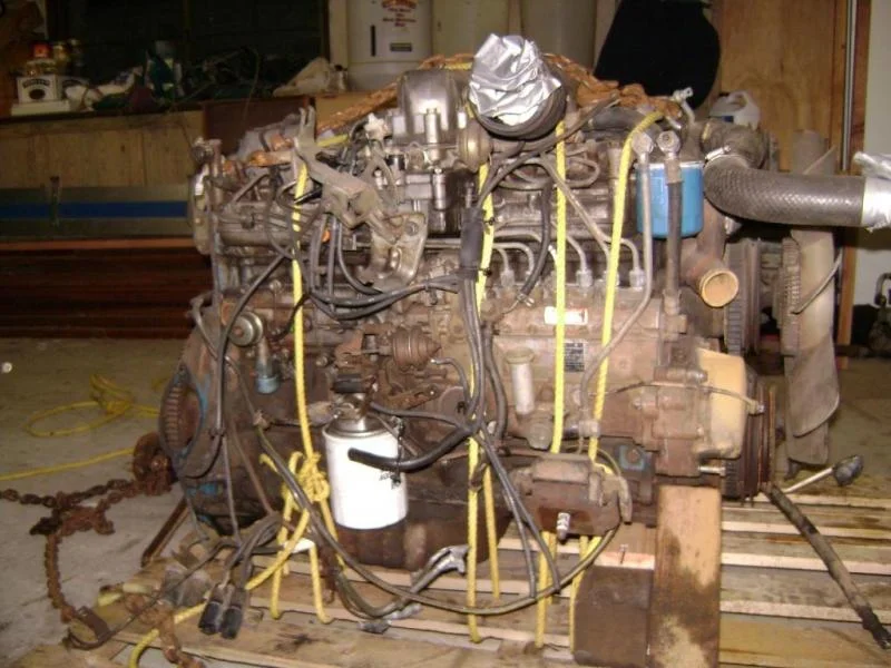

Could you post a pic of the other side of the engine?
I would like to see the drivers side motor mount.

i will be using the vacumm case. the motor now is in the corner of my garage, i will try and take a pic of it later today.

the motor is 24 volts and i will be converting it to 12. i already have the alt and starter. i also have the vsv shut off valve . anything else?

here is the pic you asked for Mel[ATTACH][ATTACH]Name:  toyota 008.jpg

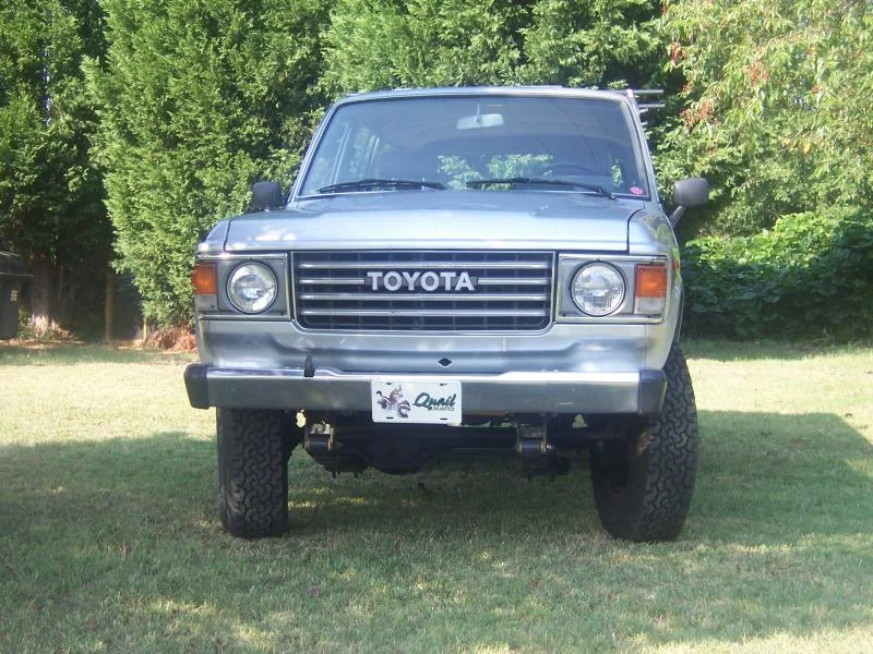

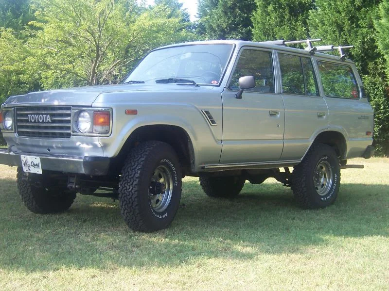

that is the 60 the drivetrain will be going in

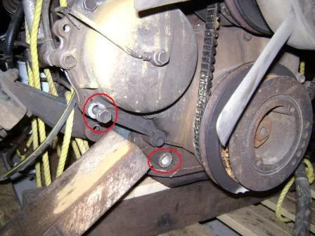

nice score on the 12H-T! i just got one myself weekend before last to go into my BJ73, goona be a while before it happens but. as you motor is still on the floor, just wondering if i could ask a big favor and take some pics of where the power steering pump is mounted to the engine? the motor i've got didn't come with it, i've got the pump and brackets and stuff off another 12ht so it should bolt up, but some pics would be much appreciated.

i am at work now but this afternoon ill try and get some better pix for you.

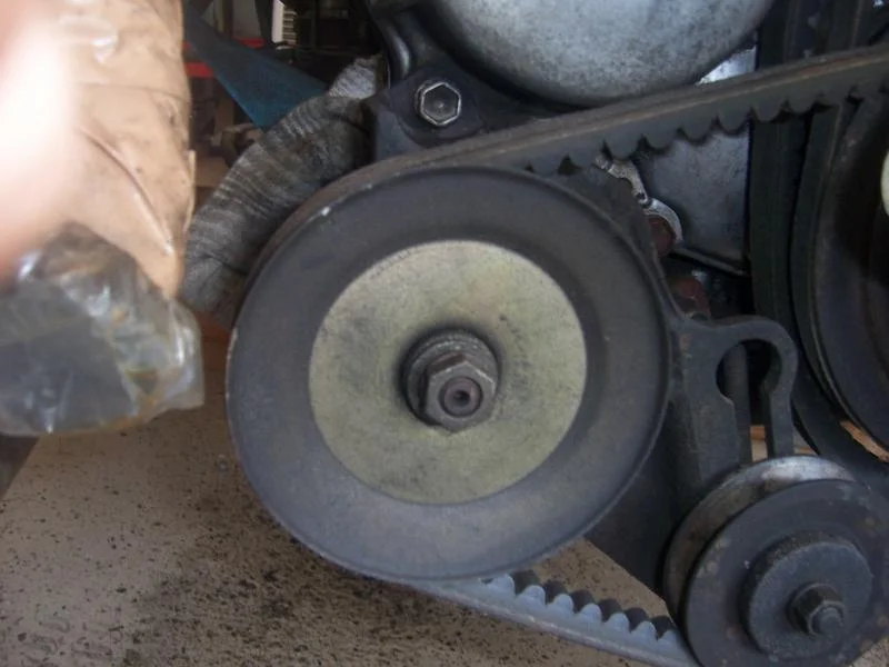

hope these pics will help you

just had a quick look and it seems like it should work, thanks for the pics should mount up to the holes i've circled shouldn't it?
it's not gonna be left standard either rosco ,so it should so it should skoot along nicely. didn't get the gearbox unfortunately, its out of an auto so i'll need to get a flywheel as well. you wouldn't know if an auto starter will work with a manual flywheel would you?
