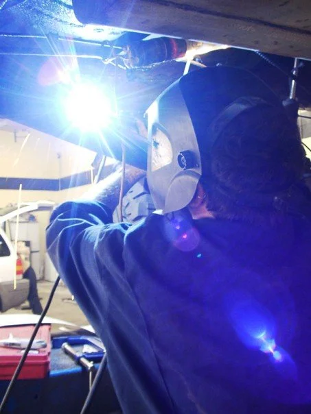

...was crawling around my 60 the other day and I'm sorry to say her days are numbered, the underside is hopeless...
I said the same thing six years ago, being from Ontario, but I've managed to fix the old girl over the years and now my Rig of Mortis has a new lease on life.

Well done.... I simply don't have the time, skills, money,room, equipment, etc. to do what would be necessary to re and re the old girl. Cheers, Tony
Quote:

unconscious welder
Breezing down through this thread and as I come up on Rig of Mortis' welding photo, I find myself being careful not to look directly at the arc................
