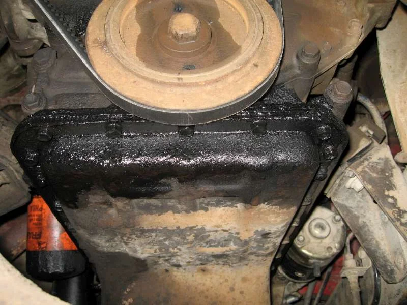

pic, haven't cleaned anything yet.

In the am before starting and on a level surface. That pic sure looks like pan gasket leaks to me.
Or the front seal.
I'd fix all leaks (especially ones that look as bad as that one) before considering the possibility that you're burning the oil Drew.

Looks more like seepage than leakage. If you had lost 2 quarts through there,the oil pn would be covered.
Fixing them wont hurt though

It looks like it the front seal, I found oil on top of the pan lip. I'll add that to the todo list.
However, I agree it'd be amazing if I lost two quarts there, I'm fairly sure I didn't. How would I know if I need new valve guide seals? Could I lose 2 quarts there? Am I right in not suspecting my oil rings based ona good compression test?

Well, I haven't noticed any smoke, but I do smell something from time to time (its tough to me to choose between diesel exhaust and burning oil). When I use the engine to brake, like when coasting down a hill without pressing the clutch, I smell "something" the most; someone told me that means you need valve seals.
I'm really at a loss to find where all this went, its frustrating.

  • On start-up after the vehicle has been left sitting for a while (where the oil has had time to dribble into the exhaust ports and accumulated there), and
  • When you first apply power again after "engine-braking down a long gradient" (where again, the oil has dribbled down the exhaust valve guides/stems). - But this time, because oil is still being continuously pumped into the rocker-area, there is usually a greater amount of oil that has accumulated in the exhaust before you hit the accelerator to burn it - So the smoke cloud should be more noticeable in this test/scenario.
Now if you have worn compression rings, this allows combustion gases to escape into the crankcase on each cylinder's ignition/explosion (rather than being contained in the combustion chambers). This abnormal flow of gas, if it becomes high enough, will carry oil droplets with it. And an engine must be "vented" to prevent this "gas leakage" from pressurizing the engine crankcase (and thereby prevent any pressure build-up from blowing out the crankshaft oil seals). Mine has a "breather/blow-by tube" that exits above my front driveshaft. So this tube will cover my front driveshaft with engine-oil if my compression rings are badly worn. Other engines may have the blow-by routed into their air-intake - Here excessive blow-by (and consequent oil-carry-over) will result in blue smoke from the exhaust whenever you apply power (- as that oil passes through the engine and gets burnt).
Now - to have oil-loss caused by "worn oil rings alone" (while your engine still has good compression on all cylinders) - Well - I'm not sure that is likely/possible. --- Is it? (Rare enough to be ignored?)
So - as you have good compression figures Drew - I would think leakage from seals/gaskets is the likely culprit - and that perhaps you are mistaken about the magnitude of your oil-loss.
And I doubt you have a valve guide/seal/stem problems because I would expect you to have noticed the significant smoke that would have generated.

-No smoke, at any time. Not even at startup after a long sit. Its warm here in the mornings (low 60's F) so that helps, but I haven't noticed anything blueish.
-Stinkiness when decell'ing.
-Good compression, but I do have blowby. I run a catch can to stop the occasional drip. (brain bender, I know)
