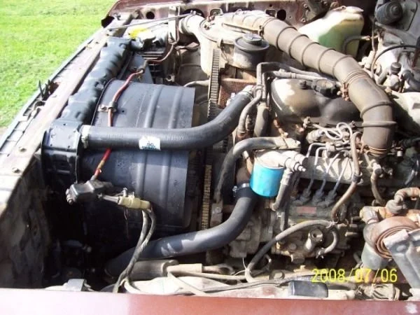

Put some time into finding some common cut to length hoses for the 60. Two reasons, I am trying to keep to a budget on this truck and I wanted parts that could be found over the shelf at any parts store, anywhere I'm travelling.
I used the Dayco online product by dimensions to find potential candidate hoses, and went over to Lordco. They brought in a bunch of hoses and I selected the best two. The upper hose I found is an exact replacement after cutting off one elbow. The lower hose worked after some trimming but I'm not as happy with the fit, though it should be ok. I used 70627 for upper and 70636 lower, cost about $35 for the pair.
