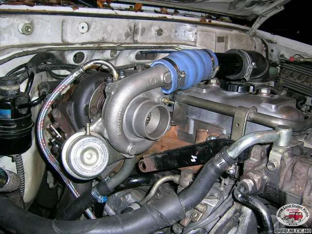

This i believe is a saab turbo on a 3B The Owner was pleased with the performance i think.

Marting, great pic. Thanks
Quote:
As mentioned in the post immediately above, I will post specs as soon as I get them.

Quote:
Originally Posted by tasnolan View Post
Pictures worth a thousand words...
__________________
TOBASH _ When all hope of logic and reasoning fail, just Take Out Back And Shoot in Head. It'll do wonders for your emotional well-being.
