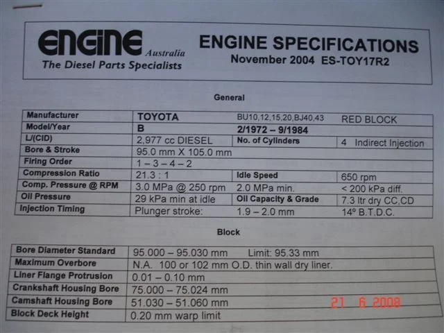

"Engine Australia" supply good kits.
And by-th-way, here's some good info from them for the B engine:
Note that it gives compression figures based on how many rpm (250) that the starter motor is turning the engine over at.
This confirms what others have already said here - That a poor startermotor/battery/etc will give low figures. ----- Which is one reason (I suspect) why people are now preferring to use "cylinder leakage testers" rather than "compression testers".
Incidentally - if my conversions are correct, 3MPa is about 450psi and 2MPa is about 300psi. (And 200kPa = 30psi)

BTW, that document is for the B, not the 3B.

Quote:
thanks (- Forgot to mention that but I've edited that information into my previous post now)

Quote:
Originally Posted by dreko View Post
whoops
1. 410 psi
2. 410 psi
3. 350 psi
4. 390 psi
So other than sorting out cylinder 3 when it arrives, I think the numbers look pretty good!
Did they give any reason for the 1st set of compression figures? I take it you have bought the vehicle .
The figures are not a disaster but #3 is out of spec. Im not sure how you would fix it without a tear down,
It seems strange that the original figures were close by a margin of a few % and 3 was equal 2nd highest and now is way down
__________________

Hey Tasnolan
1. 2750 kpa = 398 psi
4. 3000 kpa = 435 psi
All strong numbers, except for the difference between 1-3 vs. 4
Similar to my problem. I guess a valve adjustment, maybe there's a gasket leak... I have a feeling this
isn't a critically serious problem, but should be fixed at some point
Rosco: I did buy the rig. Yes the numbers looked very consistent in the 1st test, but obviously something was done incorrectly... this could explain the almost identical numbers

Quote:
Originally Posted by tasnolan View Post
Thanks Dreko, so being within 10% of each other I would be alright to whack a turbo on it, or, should I be adjusting valves etc to get these numbers the same before mod's?
Well you should definitely do the valve adjustment since that might be a free fix. Apart from that, however, everything gets expensive. Those numbers are just fine for playtime, do what you want and run it, it'll last a while.
dreko, not to be a downer, but I'm not sure I share your confidence about your low cylinder. You should spring the $30 for harbor freight's compression tester and see if valve adjustment brings it up. Then do the oil-in-the-cylinder test to see if you have worn rings. If its the rings, well, that sucks, but there is also not much you can do about so just run it till it dies. If its not the rings then it can be probably be fixed by popping the head off (head gasket/valve seat perhaps), which you should do right away before you kill what might be an otherwise trusty motor.
crushers/rosco/brownbear or other Diesel Tech gurus may have better ideas, but thats the plan i'd use.
