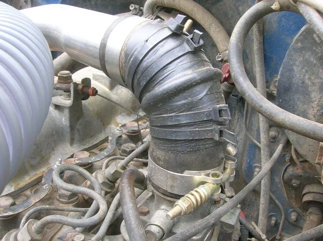

I just built up my turbo using a crazy hombrew D50 setup and it has an internal wastegate. I have already blown off one of the vacuum hoses which goes down to my injection pump a few times, and it happened again last night. I turned the truck off like I always did, and then reattatched the line but then as I continued home, the wastegate seemed to open up alot earlier, as it seemed like I had no power with higher rpms and a big wistleing sound. Checked things out and everything seemed normal. Could I have blown my turbo? it seems to work at the lower rpm though. There is a big exhaust leak right after the turbo which I have plans for fixing, could that be a problem?
Also I haven't got a pyro or boost gauge (onn order) so I haven't cranked the fuel yet. Any suggestions greatly appreciated, since I don't know much about turbos, only had one for a few weeks and only really know anything from the stuff I read here on mud.

A big rush or air usually means that your turbo is working great - but there is an air leak from the turbo to the intake manifold.
Check your connections and pipes - or like what happened to another BJ42 that was out with us last week - his air intake flex hose that is attached from the airbox to that little plastic duct uder the hood collapsed while under load - you can't see it until you throttle it. Take it offf and throw it away if you haven't already.
When I first put my intercooler on I had a huge rucking air cound - it was a bunch of loose clamps and pipes that weren't sealed well.

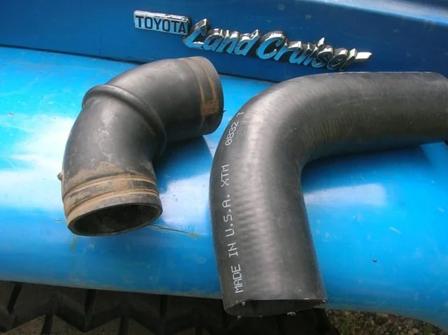

Ok, I found the problem. Before I drove it, I tightened the clamp and took a closer look at the stock rubber 90 at the intake. Looks like the elbo had split ever so slightly along the inside mold line and probably leting out a lot of the boost when it started getting pretty high due to the higher revs. Anyway I used a lot of electrical tape around the elbow and then two zap straps, which did ok for the test drive. Will have to order up a silicone pipe custom elbow, anyone know where to get one?

Mine did the exact same thing last month on the highway. I used rad hose to replace it. 30 bucks from napa. Look in there book. The ID is 2.250 inch.
I got to replace mine in Swift Current on route to Calgary. 13 psi is where everything pops open. IP air lines etc. 10 psi I had no issues.

Finally got a coolant hose to replace my bandaided stock elbow, and works good now. My question is to all those turbo people: is it common for that top hose on the intake (top clear line in the first photo) to blow off once the engine gets warm and the boost climbes high ?(still waiting on gauge, so don't know exactly the boost I am getting) If it has happened to people, is a simple fix just to put a hose clamp on it?

Yes it is common - lots of guys have it happen.

Mine lasted like a day, the little clear hose that is. I used real hose clamps then it just blew a hole in the line. I replaced it with some hardend rubber. for my elbow and the rest of my piping I used Silicone Hose - TREADSTONE PERFORMANCE
best $ I could find on 90* elbows, tranistions, humps, clamps, etc.
