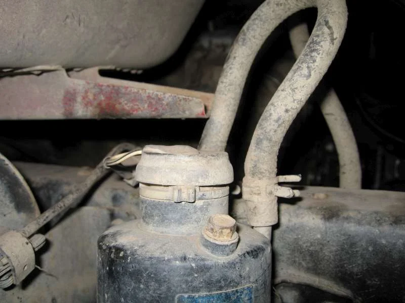

I found that some clever new zealander had disconnected my sedimenter and just looped the tubing from inlet to outlet. which way *should* it go?
Also, if I disconnect the line from the tank, am I going to get diesel everywhere?

the tube on the sedimenter that is closer to the rear is the inlet. So from your picture right is inlet left is outlet.
If the tank is full yes there will be diesel everywhere. But here is what you do. I use a vise grip on the hose from the tank so fuel does not come out. i ONLY connect the hose from the tank on it. If the tank is full fuel will go in the sedimenter and push the air out the outlet. When fuel starts coming out of the sedimenter you connect the outlet hose on it. Doing this will avoid leaving the air in the system and avoid you to have to prime it when it will stall.
You should even do this when the tank is full. If too empty you will need to suck the fuel in the sedimenter...beurk....
But before you do this, why don't you take the sedimenter off the frame, put it in a vice and unscrew the plastic cap. To check the float inside and also clean it. check continuity on the wires when the float is down and up. Up you should have continuity

If you look closely on top of the sedimenter can you will see the words 'IN' and 'Out' pressed into the metal, so that should help clarify the connections.

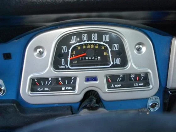

Best one I got. Its in the same brick as the parking brake light just to the left of the instrument cluster, and has a yellow lense that says "Filter" on it.

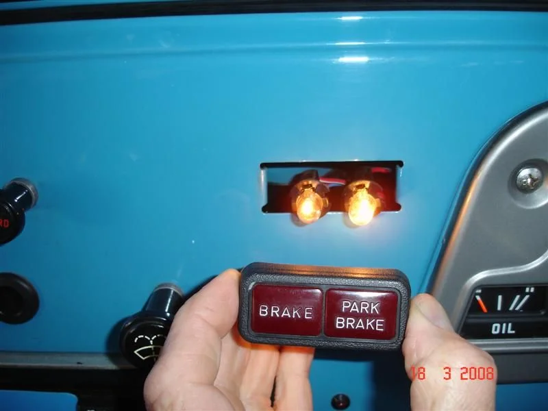

I have two red lights.
My left says "brake" and comes on in response to the low-level detector on my brake mastercylinder dual-reservoir. (It also comes on whenever I engage the starter motor as a "bulb check".)
My right says "park brake" and lights whenever I pull up the parking brake lever. (Which you people over there refer to as the e-brake. - Which I'm assuming stands for "emergency brake".)
Damn. I know I've posted in other threads that NZ/Aussi BJ4#s never had sedimenters. Obviously I'll have to try and track down those posts now and correct them.
Anyway - I definitely don't have a "Filter" light.

I did as you guys suggested and tested the sedimenter (it worked fine) and managed to put it back in the loop without bleeding the system. Its nice when things go well.
Is there some "local wisdom" in NZ that says to bypass the sedimenter? Given that Joe's was bypassed similarly and I found another post here one mud by someone saying it'd been recommended to bypass it...?
Attachment 239211

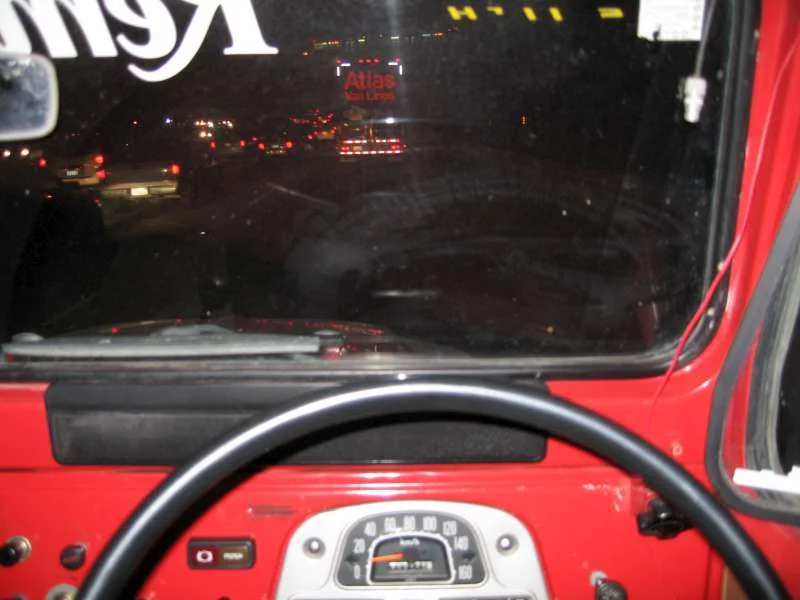

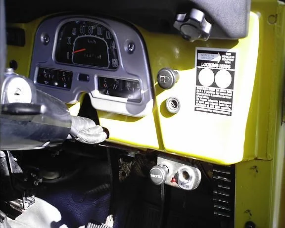

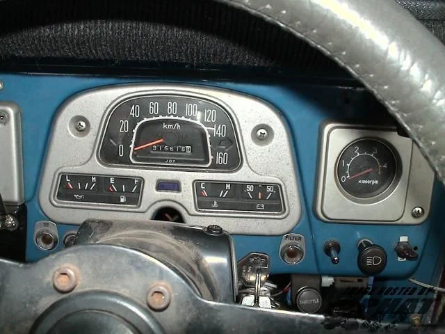

LostMarbles,
don't worry too much about the difference between your dual warning light arrangement and the other one with the yellow 'Filter' lens. They were used in markets where the rules about having a seat belt warning lamp were absent presumably. What Toyota did in markets requiring a seat belt warning light and brake warning light is that they take the filter lamp and put it solo elsewhere on the dash. As far as safety concerns go, it would make sense to prioritize the brake warning circuit and seat belt warning light, and make them nice and prominent on the dash, over the sedimenter circuit, which gets relegated to a small solo lamp.
some examples follow - maybe your vehicle has a telltale hole in the dash, or a missing bracket. i can't believe trucks for N.Z. would be spec'd without sedimenters and if you have a sedimenter, then you have a warning light associated to that, along with an inline diode.
