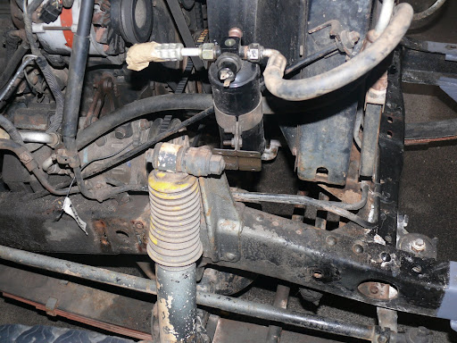

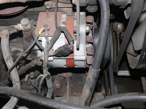

Here is a pic of my setup. Not sure what pully was used as I bought the truck like it. The AC will not go back on after the frame off...
