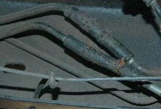

if you want to go fast and easy.....cut the line...use a fuel line on top ...butting them up to each other....and 2 clamp it....its an old PO trick
you too can be the PO everybody talks about
something like pictured but with better clamps
