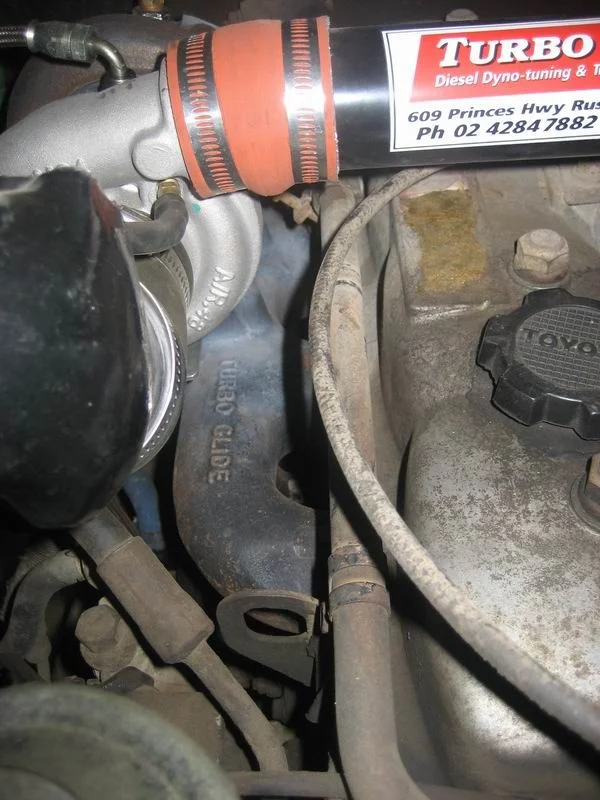

what is the white? could the manifold turn white?

all my exhaust leaks have been black and sooty. Yours could be exhaust... but maybe it is burnt coolant. I dunno. Is it coming out around the exhaust flange?
Wipe it clean if it come off and see how long before it re-appears..

The white won't go away, i've put water on it, and scrubb it. It dries and come back just like it was. And the white is mostly near the turbine, (hot side). So my guess is that the paint on the manifold is changing color.....i guess.

I think you are right - paint is changing colour.

Yah I would not worry about it.

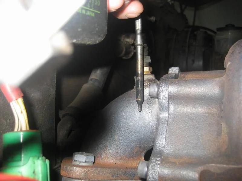

Turboglide, says white = excessive heat, check EGT. But i never cross 900 deg F long full load. Right now at 100 kph on a leveled road i'm at 750deg F.
Here is a picture to show how deep the pyro probe is in the turbo outlet elbow. Do you think it is not deep enough? i personnaly don't think a 1/4" or 1/2" deeper would really change anything. But i maybe wrong...

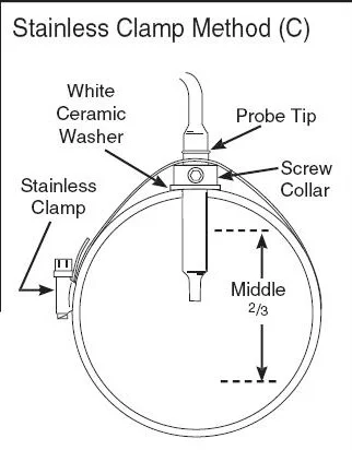

I'm not in the middle 2/3 tho...

your picture of how deep you are never showed. It might matter. But I guess not too.
The white stuff, could it be soap that is dried on from a car wash etc?
Like I said I would not worry.
What PSI are you running on your turbo. I run 10-12 psi max and hardly ever see 800-900 post turbo. Average higway is 600-700 for me.

I washed the engine with a hot water pressure washer lately. But no soap there since it was installed.
I've added the picture to my link. If i had a manifold leak, shouldn't i notice some black carbone build up where it leaks? Also the probe is not perfecly leveled with the steel bushing. It should be 1/16 to 3/32 higher.
Boost never go over 10psi. Seems limited by the waste gate.

Thats what I think. I can see my little leaks. Black little streaks. If you don't see that I don't think you have a leak..
Yes your probe could go in further. But unless you can thread the bushing in further that is what you have to live with. I doubt mine is much different. I welded a fitting to my elbow. So I think we are the same height.

Hi all
The pyrometer is a thermocouple which needs to see temperature difference between the tip and the other end (connection to the lead wires) if there is no difference the reading will be lower or zero! I would tend to keep the probe in the minnimum distance? or you could check it with a propane torch, try heating the tip only (record the temperature) and then move the heat up the probe to see what happens to the temperature reading does it increase or decrease. This will give you an idea of the correct depth.

Quote:
Originally Posted by freebie View Post
Hi all
Cheers
Yes and no. A pyrometer is a thermocouple but they work on the basis of:
A pyrometer consists of two parts: a thermocouple and a galvanometer
The thermocouple works on the principle that if two dissimilar metals
are heated where they join then a small electric current is generated.
The galvanometer is really a millivolt meter, because the current so
generated is in thousandths of volts. Most galvanometers are of the
swinging-arm type although digital ones are now appearing on the
market. The swinging arm type is very sensitive to knocks, dust, heat,
etc., and most malfunctions occur because of these factors. This type
is also less accurate, as its scale is limited in size and it is not
easy to differentiate between the 20 C calibrations so that
effectively we can only be sure of a reading of plus or minus 10 C.
I got this from a potters website but the principle is the same. I think in an immersion situation like the exhaust over time say running on the highway the whole Kprobe(thermocouple) would become relatively uniform in heat. I'm not posititve on this latter part but I think the temp difference would be minimal. also know from my job(HVAC) we use thermocouples all the time and I have never heard of the keep the wire end cool as it won't work. I have seen times where a shoddy service guy has placed the whole probe completely in the pilot flame and it worked just fine.

Hi Burger and thanks for the insight, you may be right but the simple test is to heat up the probe and see if it changes the output to the sensor?
The thermocouple will definetly not respond correctly if heated through its entire lenght, try one with your torch and a millivolt meter :-)
