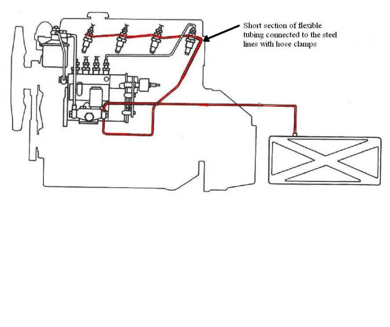

How are you getting on?
Here's a drawing of the fuel circuit from the manual:
I've coloured (in red) the "suction side" of the circuit where you should be looking for leaks.
That little bit of flexible hose I've pointed to is very prone to leaking because it gets a lot of heat from the cylinder head and often the hose clips don't fit the small tube size very well (and are therefore difficult to stop leaking). And being so high up - You NEVER get diesel leaking out there (unless you pressurise the fuel tank).
lostmarbles is offline   Reply With Quote

Thanks Tom for the diagram. In retrospect I went to the last step too quickly without carefully looking at everything. I now have all the hard lines off and someone is testing them for me. Before the hard lines came off I replaced the small flexible hose on the return. As you have experienced, I could not use the proper hose clamps and had to use zip ties. The were closed tight but may have leaked because they were up high. I never second guessed the new line and zip ties but now wonder if that was the problem.I also replaced the hard line to the tank. This was the line I thought was causing my problem since I found a 3mm hole in it with a small clamp over it. This line was replaced with a hand bent brake line of same diameter and with proper clamps.The primer pump does not leak when pumped but has a bit more side to side motion I would guess, this is my first LC so I don't know for sure.I am currently pricing replacement hard lines. I found used ones but the price seemed much to high. Tomorrow I will pickup the new fuel filter, hopefully the Fram is the correct size unlike the Napa gold filter. The filter should rule out some more trouble spots. I'm also going to check with mcmastercar.com to see if the have the proper clamps. They are a web based hardware store with almost any type of hardware you can imagine. Thanks very much for you input, I'm sure I will need your experince again as soon as I have the parts and time this weekend.

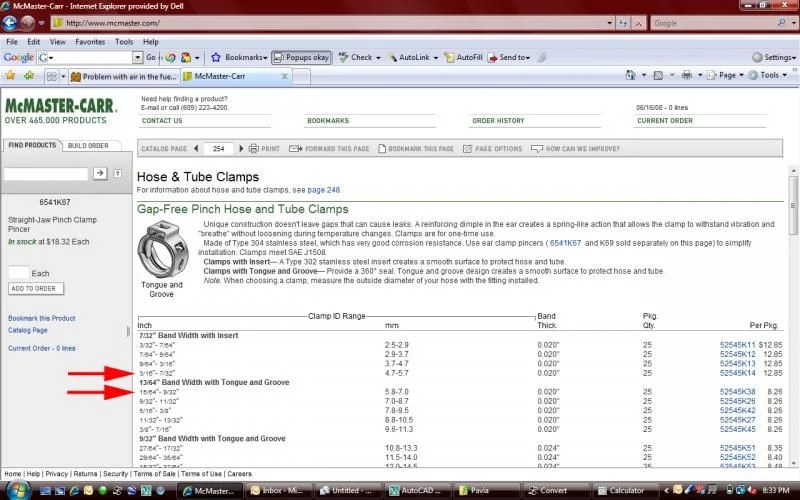

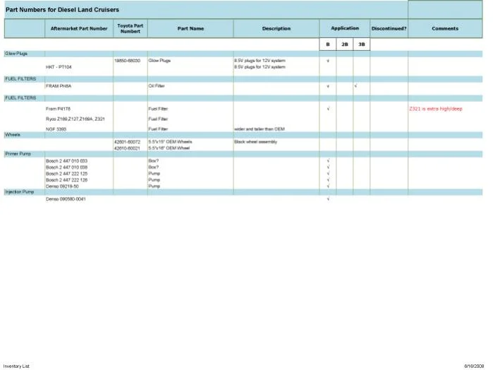

I was just browsing mcmaster.com and found some one-use band clamps similar to ones I just removed on my wife's fuel filter on her bmw. I like that they are stainless and come in very small sizes. If I decide to buy I will let you know what I think...The installation tool is the most expensive part but I can use it on other projects in the future.
I spoke with someone at EBIcruiser parts and was told they could get new lines. I'm waiting for a reply for costs and availability.
I think I will hold off on installing the primer pump, at this point I do not want to add any more potential problems until I can get it started for more than a few minutes.
I ordered that fram filter, I think I found that number in one of your previous posts. BTW, I am putting a spread sheet together for part numbers and will attach it to this thread. It is just getting started but I would like to have a few people like yourself comment on the layout and content and columns that should be added. I think that having a refernce list in one file would help everyone on MUD. When I finalize the layout I will be happy to try to put all the part numbers in the file and share with everyone again.

Those clamps sure look good and so does the spreadsheet Albert.
And soon we'll have more info for our B engines on MUD than there is for the 3B!

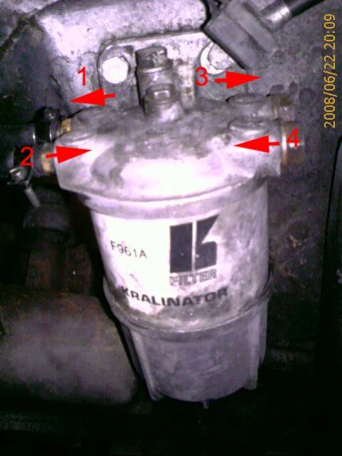

On the pump body I do not have an O ring, on the filter bleed screw there is a small rubber washer, I'm not sure if it is original however. Do you know where I can get replacement screws for both positions?
Well, I spent the weekend putting all the old fuel lines back on the BJ because I did not find any problems with pin holes, etc, even where there are welds. After getting it all together late last night I still had a tremendous amount of air in the system, so much so, I could not get any fuel pumping. I returned to the forum afterwards just to check if anyone else had any similar experiences. Nothing was an exact match but I was inspired by a thread regarding the water separator leaking.
This morning, I found that one of the lines (return line from the leakage pipe at the pump body) installed yesterday was not properly torqued down and that I will definitly need a source for the metal/rubber washers used on all the fuel lines as they are all quite worn out. After trying to get her started I still could not get the lines bled. I decided to try to bypass the water separator and a few pumps later I was able to get the BJ started and running well all day I would like to make sure I use the separator becuase during the trouble shooting process, I found a large amount of dirt in the bottom of the body, about half full with soil. Attached is a picture of the separator, it was made in England and has a Kralinator filter on the top part. The bottom has a rubber seal that is a bit worn, the top seal is accomplished by the filter and I am not sure if a new filter comes with an upper gasket or seal. Lastly, the separator has 4 inputs, the way the truck was setup was that the line from the tank went into port 1 which has an arrow pointing out towards the tank? The port labeld 2 has an arrow pointing in towards the separator and was rounted to the pump body? The filter on the separator is a Kralinator F961A. Can anyone let me know if this was a standard item on my BJ and if I should re-route the lines following the arrows? Where can I get that filter as well?

Hi Albert. That looks like a generic type filter head to me that takes a very common type filter and they are well proven.
I see them on ebay and my parts store sells them for $59
You do get a new gasket when you buy the filter(well I did and mine is same type)
If I am correct ,yours is the Racor/Delphi 296 type filter.
Most of them have a glass bowl so you can see the crud or water,but yours has a metal container
The best bit about those filters is you can get quality replacements for peanuts,$6-7
I fit them on the bench to makes sure I get the o rings right.
I think there are one way valves in the couplings that can allow fuel to flow backwards when they are worn out. You can probably buy replacement parts at a good diesel shop.
The filters are good for about 50 litres an hour
