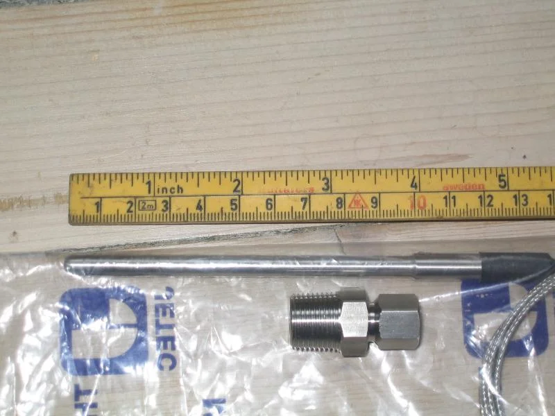

I haven't installed the pyro.. I got cold feet because I think it might be to big.. the sensor is quite big..about 10cm long
How big are the sensors usually? If i can confirm it'll work i'll install it.

Wow, 10 cm would be way to long if that were just the prob which was below the threaded section. Got a picture with a ruler beside it to show us? This is what my thermocouple looks like and it has about 1.75" sticking past the threaded section.
IMO, smoke is not a good indication of your EGT's. My truck doesn't smoke at all, but on a long climb, I can easily reach 1200*F (still with no smoke), so just be careful

Ok..it's not that much bigger.. as you can see about 60mm past the nuts.. with those welded to the outside of a pipe i guess about 55mm will have to be inside the pipe.
My plan was to insert it in the "elbow", right after the flipped manifold, from behind  and go horisontally forward..
Maybe i should just go ahead then.?
Yeah I'm being careful
