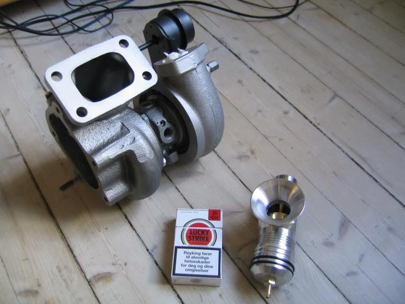

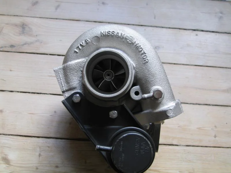

THE SEARCH IS OVER!
I have bought a turbo.. Garrett/Nissan... was supposed to be sort of in between a GT25 and a T3.
From a singel-turbo 300zx
I honestly dont know A/R figures and stuff... It looks big enough. Hopefully not too big. The guy i bought it from sells lots of turboes and has tried "everything" so i followed his recommandations (an enthusiast not a vender)
Lets hope it does the trick!
It's oil and water-cooled.
I got a XS pop-off valve too.

I hate to put a damper on your enthusiasm, but I had one of those turbos and sold it. They're not suitable for diesel use as they can't produce boost at low flow without surging.
It's called a T25G.
The compressor wheel has a very high trim (intake diameter is very close to the overall wheel diameter) which allows the boost to surge back through it when you try to get high boost at the rpm that diesel engines run. This surge over time damages the compressor blades, when they fail they head into your engine.
The T25 I'm currently running is a 60 trim which has a 40mm intake, that one is 74 trim which has a 44mm intake.

Yes it's a no go. But on the bright side, you should find plenty of ricers who'll be happy to swap a normal T25 for the T25G.
They're rumoured to flow more than a T28, but I haven't found any compressor maps for them.

Aaaahh I see.. hehe ... Yeah i guess that is the one i should have too.. But I'll go with the one i bought now..maybe it works great?! If it turns out to be hopeless the seller will get me something else..
I still wanna see your plumbing though..if anyone can give me links to other plumbing-pics it will be much abliged.
Doug! Any idea on what boost the non-adjustable wastegate on my turbo is set at? I'm guessing 8 psi ? whatyathink?
__________________
HJ60..OSLO
For example .. my CT26 non adjustable wastegate, it's set to 10 PSI .. after that it start the opening and you will see the overboost light in the das ..
But it's pretty easy solve it if you want more boost ( BTW disconected wastegate, means more than 20 PSI of boost ) with a boost controller ..
Halmans Manual Boost Controler .. ( don't waste money in those turbonetics boost controllers )
__________________

Hmm.. I see... So if one uses a boost-controller, one can "move" the opening-preassure on the wastegate upwards? I mean can i keep the wastegate as it is and then use a B.-C. to give me more or less boost?
Curious about some plumbing..
There is a nipple on the compressor-housing and on the wastegate (dont know the name.. the part that holds the spring)
These two should just be connected with a hose right?
And if i use a boost-c. it sits between those?
And as i mentioned, what about the hose from the "throttle-body" to the IP What does it do? Is it vacuum from the intake that regulates the fuel-flow?
Can i move it from the intake to somewhere before the turbo on the air-intake.. I'm guessing it will be about the same?
I also wonder what are the best places to take/return water to ensure a good flow that doesnt stop or change direction under any condition..
The oil will go from t-piece behind the oil-pressure swicth
Also the turbo is pretty heavy. Have you guys used any supporting brackets to hold it, or does it only hang from the manifold?
The pop-off
(wich I guess is overkill for my application, but it sounds cool)
It goes on the intake-tube right before the intake right? where does the hose, that there is a nipple for on top of it, go?
One more thing.. I keep calling them "hoses" is that correct? or would "line" or "pipe" be more correct.. I'm thinking a pipe is something made from a hard material... like a plumber would use
and a hose is soft made from rubber etc..Maybe tube is a better word? Are hoses for gardeners and firefighters?
I think I have a pretty good english vocabulary for a Nordmann..But there are some "holes" in the technical departement
You guys (especially you Dougal) have been very helpfull....
I think I'll have to ship some delicious Norwegian beer to all corners of the earth when this is "over"...as a token of my apreciation.

For boost control I prefer to cut the wastegate rod and weld in a threaded section (be careful not to overheat and burn the seals). This lets me change the boost from almost zero to the maximum the turbo can produce (wastegate always closed) with just a 10mm spanner.
It has the advantage that it holds the wastegate closed tighter than a boost controller so it doesn't open by itself.
This is what my T25 looked like two years ago. You'll notice the plugs in the side, I don't use the water cooling.
__________________
VOODOO Engineering: Doing it first time with one clay doll, not four times with two.

The Manual BC are a great option for us with a non adjustable internal wastegate and also don't want to cut and weld anything in our setup .. actually it function and are pretty accurate the setup .. you can set it to 14.5 PSI if you want .. at least mine.
The MBC go between the turbo compresor housing and the wastegate itself .. in my case halmans MBC block the pressure that normaly goes throught the hose from the compresor to the wastegate to activate it ( means start bleeding exhaust pressure in the turbine side to control your capabilities to build boost ) ..
Blocking this " signal " your wastegate keep closet alowing you ( your engine ) build more boost until the wastegate start open due to your settings ..
The MBC allow you to " lie " to your wastegate building more boost ( even with the risk to go over your surge line or sure out of your eficiente island in the compresor map ) but it don't affect the process to build boost sooner or later ..
