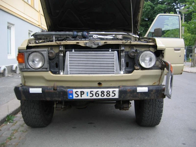

It is time to quit fooling around. I want to see pictures of your intercooler or else some hot oslo chicks... or both.
Edit: Only pictures of the intercooler. I don't want you to get in trouble

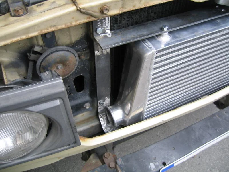

Ok Dougal.. I checked.. The turbo is called GT2652. I can't find it in Garrett's catalog
It also turns out it's from the D5 163hp diesel-unit. So i guess that makes it to small..
Rick! Ok dude!
By the way.. That is my girlfriend, so no sleezy remarks!

That looks very nice.... it looks very clean but a little tight. How big are the openings and how much did you pay for it? the intercooler

I guess in Norway you don't need air conditioning. The condenser for the A/C mounts in the holes where you have fastened your frame for the intercooler. I am looking for a solution to cool the air charge without cutting the body, so my options are limited by this.

Quote:
Rick
The openings are about 55 mm . I payed 2000 Nkr (400USD) and i got lots of aluminium pipes, silicone bends and expensive hose clamps.
I'm pretty sure it's more than big enough. ( a bigger one would fit poorly) I will cut holes in the frontplate right below where the small oval hole is now..
Aircondition? Nah... it would be nice to have for maybe 10 days of the year.
The holes i mounted in are actually used for a roll-down curtain!
To keep cold air off the radiator in the winter
Only the last few years have a/c been "standard" on cars sold up here. In 1983 only the biggest Mescedes' would have that.
Normal temperature in the summer is 15-25 c and maybe up to 30 on a few warm days.. I think the warmest ever recorded in Norway is 36c
In the winter it will sit between 0 and -15 here in Oslo Further north and at higher ground it can drop to -20 Coldest ever is around -50c

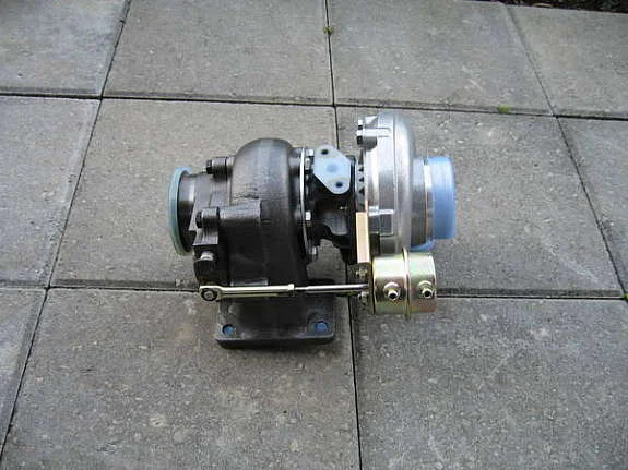

Could this be a candidate?
It saya it's a T3/T4 with exhaust ar.63
__________________
HJ60..OSLO

Quote:
It's a little bigger than I'd like, but it'll work.
