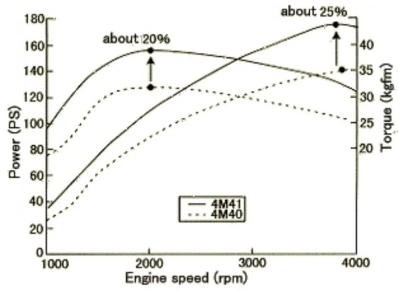

Hi Ohlins,
There used to be a press release release on the Mitsubishi website dating back to 1999 and describing the 4M41 motor, but I can't find it any more. The engine is used in the DiD versions of the Mitsubishi Pajero (Montero in the USA, but the diesels are not sold there). Up to 2006, the 4M41 had an electronically controlled rotary fuel injection pump, but current versions have common rail direct injection.
The 4M41 is a 3200 cc (195 cubic inch) displacement 4 cylinder direct injection diesel with double overhead camshafts and 4 valves per cylinder. The bore is 98.5mm and the stroke is 105mm. Compression ratio is 17:1. I have attached a rather poor quality image of the power and torque characteristic graphs (compared to the older indirect injection 2800 cc 4M40 motor):
There are a number of companies that offer performance enhancement packages for the 4M41 via piggy-back engine ECUs. One of these is Dastek.

Ok..thanks for that...i`ll do a web search on that engine model number and see what I can pull up....does`nt do any harm in case needed for future reference eh??.....I take it they have a good record over there in your sunny clime???
