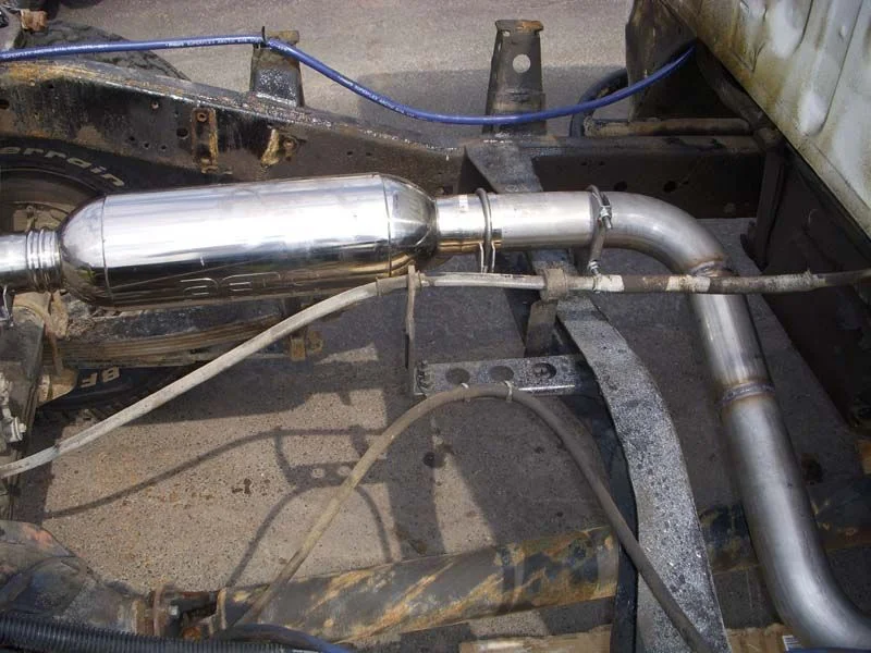

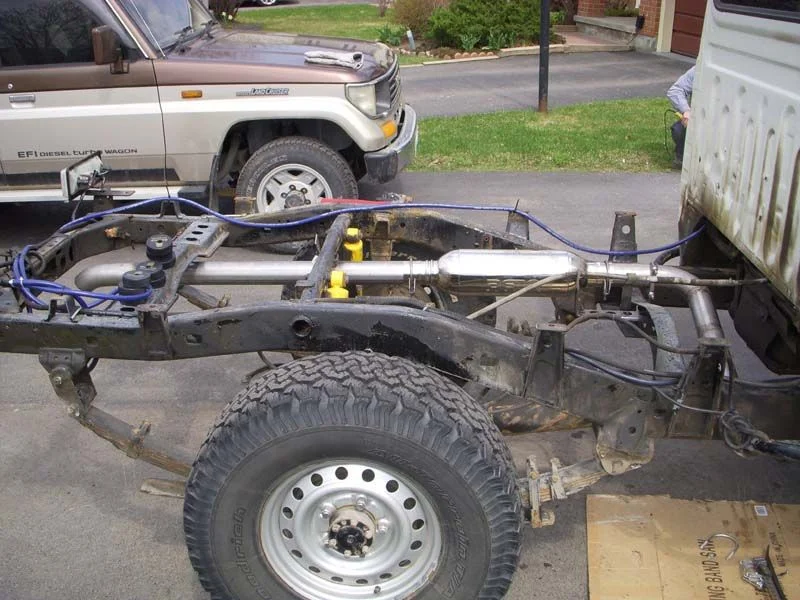

I just installed a 3" stainless exhaust I imported from Beaudesert Exhaust Australia . It came complete with a 3.5" dump pipe,high flow muffler,resonator and fit on all the original hangers . It was some what expensive ;$2000 landed; but the difference in performance is well worth it. The turbo runs much cooler; 600F as compared to 1200F; on some of steeper hills here in British Columbia. The truck gets up to highway speed quicker and seems to use less fuel. I haven't refueled since putting the system on. I should mention I also put a snorkel on at the same time . On a run back to the Okanagan from Vancouver ,with about 1000lbs.in back ,I maintained 100KMH even on the hill up to the Hope Slide.I usually do 80KMH up that hill,but boot down a number of times and the EGT gets up to 1225,this time it reached 600. If there are any other HDJ80 owners interested in this system I do have pictures of the system out of the box and the list of parts . I should also mention the Aus. dollar is worth about 90cents Can. so some money is saved there. I would call this very positive and satisfying experience.

WOW, railswitcher, that's a fantastic looking system. Best I've seen so far! Spendy, but certainly looks perfect!
If it could be had for $1,000, it would sell for sure. If loacl custom shops can do SS systems for $500, I'm sure something of that quality could be be done for around $1000. The price you paid takes into account that Australians earn in average much higher than Canadians plus the tremendous shipping and import fees. How much was that in the total cost?

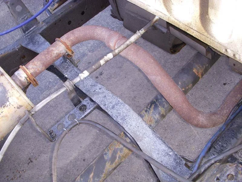

In reply to Towpack ,the dump pipe is attached directly to the turbo and the down pipe attaches to it. It is the second picture;the pipe by it self with the bag of parts.

Here is my system, I bought the 3" mandrel bends, SS304 or 309 IIRC, I thne cut it and tack welded parts of it, then brought it in to a shop for TIGing. I used an Aeroturbine muffler. Sounds great, nice and quiet at most times, when hammering it sounds like a champ.
YouTube - HZJ79 turbo aeroturbine landcruiser
