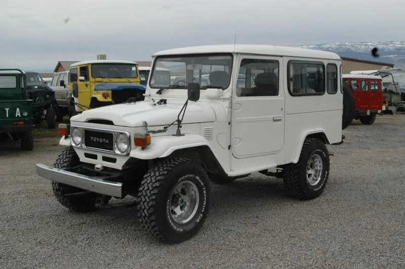

I am the proud new owner of a BJ 44 and was wondering how hard it would be to fit an extra fuel tank. I am looking for a 10 gallon option with the mind to eventually run a dual tank WVO system. Any thoughts?

Very nice looking truck! Makes me want to buy one again.

That's a great looking rig. I'll bet it wasn't cheap!
