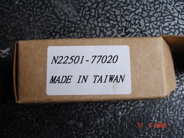

To be honest, I was wary of it to start with because no brand-name was displayed on either the item itself or the box it came in. (What sort of manufacturer would make an item and then not want to proudly display their brandname on it?) All that was written on the box was "made in Taiwan" as I remember. Also, the copper washer that sits under it was the wrong dimensions so I had to reuse the original Toyota one.
Now I know some people out there will just say: "Serves you right. You should have stuck with OEM." But I don't see it as anywhere near as simple as that. - I have had poor performance from OEM products. (My door mirrors are an example of that - They cost something like $80 each if I remember correctly and the plastic cracked on the corners around the mirror-glass within weeks of putting them on!)

Roodogs Taiwan 22501-77020 ($A40) - This is the primer pump that I am giving the "thumbs down" and it was sold to me using a Toyota part number as you can see.
