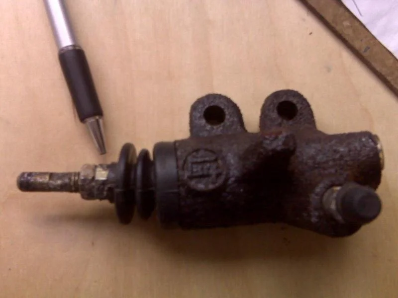

Here is a picture of the slave cylinder. The pen points to the adjustment nuts...

I would go with the above suggestion (bleed off the pressure) if you open the bleed screw slightly you will be able to compress the rod into place. Keep out of the way the fluid will squirt out hard enough to spray you in the eyes.
Once the bolts are in it would not hurt to flush a little of the old dirty fluid out through the bleeder while you top up the reservoir.
When you adjust the linkage just bring the pushrod up againest the clutch fork, and retighten the lock nut, then check your pedal play.
Good luck

I should have included a few more details-
its a 82' BJ42 with a H41
I bled fluid until the rod pushed up hard to the end-
the 'lock-nut' on the rod (pictured above) made no sense to me as to how it adjusts anything certainly not in the direction I wanted (this is probably what I am stuffing up)
So basically with the push rod all the way in and its end seated in the hole for it in the clutch fork It was a few mm too long to get the bolts in the hole- thus had to try to pull from the back on the clutch fork.
I'll try today to see what I missing with the lock nut- that really is the only thing it could be-

There are two nuts on the pushrod! you will need to grab the rod with pliers or vise grips, then loosen the first nut adjust the second one (near the cylinder) then once it feels right re-tighten the lock nut.
The boot you are missing cost me over $40 CDN two years ago!!! its a part number 31126-36030, but thats the North American number ??

Thanks Freebie- that part number may save me a lot of time-
what I didn't get with the push rod is that the back nut on mine appears part of the rod- and doesn't move- making any movement of the forward nut irrelevant- I could have had this wrong though...
I the starter off today with no drama's (off is easy) and was busy with other stuff- so didn't have a close look at it again- but will soon.
