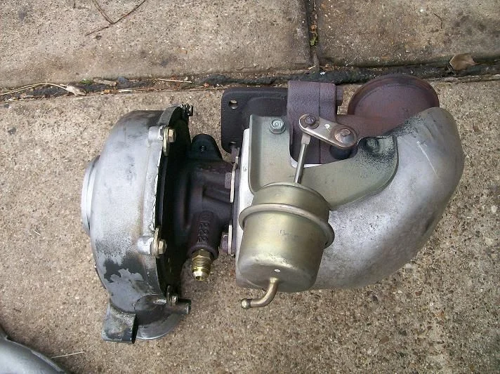

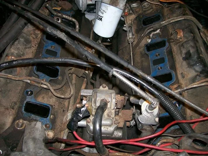

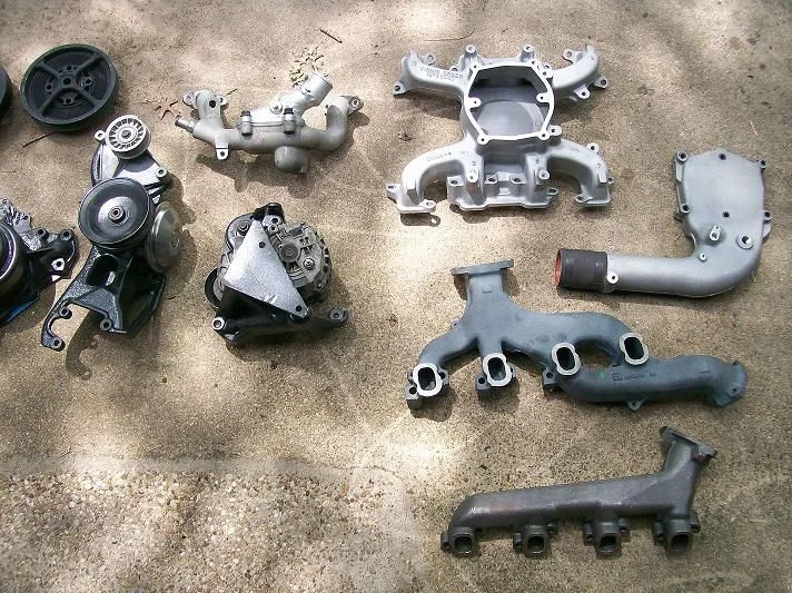

I have just started my turbo upgrade on Dragonazul, my wife's Diesel FJ80. It has a Chevy 6.2L Diesel and uses the stock A440 transmission.
I am using the 6.5L Diesel turbo, intake and exhaust manifolds. The goal is to have about 10PSI of boost.
Also purchased all the parts to do a serpentine conversion. i am throwing my alternator V-belt every month and have to tighten it every week. Randy looked at it and explained the alt. bracket is off center. I still want the serpentine.
The truck is now at Randy's and he will perform the magic to get it setup and running perfectly.
I have some engine before pics @
6.2L Diesel
Previous to the turbo, the truck runs well and has some good power. I am not an Automatic type of guy, so I do not like it shifting when it thinks it is a good idea, but I can get used to that. The goal is to tow with the 80, so I decided I needed the turbo.
Will keep you posted.

The GOODIES
Sorry guys been buried trying to get all the trucks out of here. But here is a couple pic's of the parts that will be going in. 6.5 turbo manifold and exhaust manifolds and the turbo. All of which are being converted to a serpentine belt system. Get you some tear down shots here in a few. Didn't have time to resize all of them so this will be a taste.

Sorry guys been trying to get this one tied up. If I post the pics out of order forgive me, I am wrenching and trying to remember to snap as I go. But here are some shots of the teardown from the other day. All of the front access. Are off and the intake is ready to go back on. The exhaust flange is the real PITA. I am also waiting on the arrival of the new gauge set!
